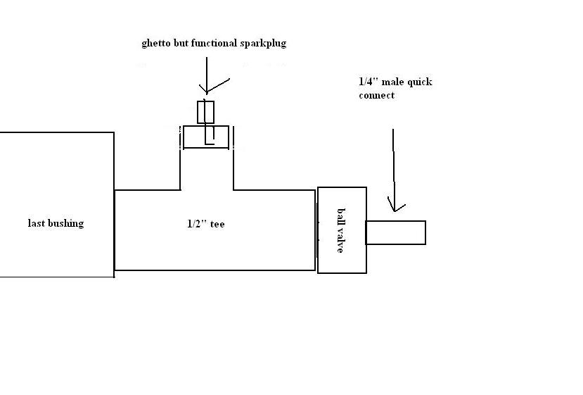

First, the relevant specs of my cannon:
  • 2x12" chamber plus a lot of fittings
    manometric metering
    ignition: camera flash+ignition coil (tested to work at pressure)
(see picture for configuration of spark and fuel)
Anyway, the cannon won't fire reliably, but does fire occasionally. It does fire reliably if, after I fill the chamber up with air, I pull off the hose and vent some of the air/propane to atmosphere. I guess this mixes the gasses. My question is whether or not I can do something simple and cheap to mix the gasses better without venting any. I read in another thread about adding a venturi, but no one else has needed anything like this to make theirs work.

With the 1/2 inch T, there is an excellent possibility the plug area is mostly air and too lean to fire. After filling with air, venting a tiny bit to expell the air and draw mixture to the plug may be helpful.

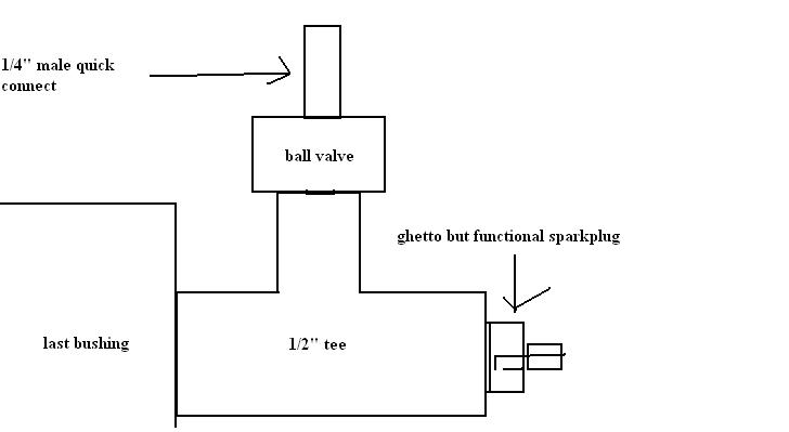

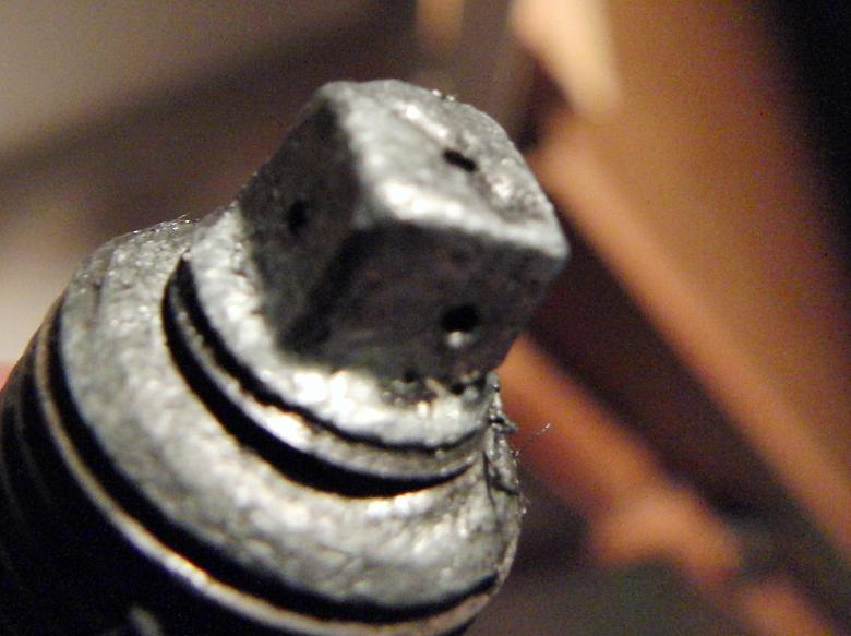

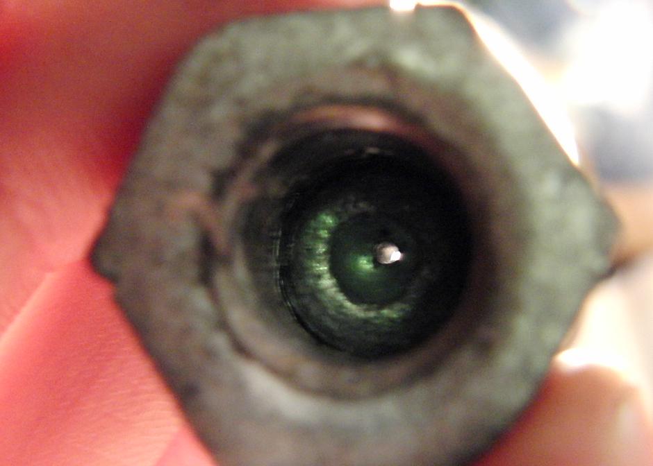

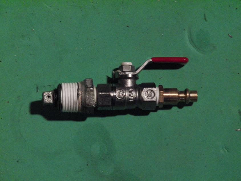

I added a venturi type thing and still have problems! here are some pictures. Even after waiting 3 min, it won't fire. would the configuration shown in the first picture be a better configuration than the one in my first post?
Thanks
revised configuration

the whole air assembly
the ~.054 hole
the ~.054 hole
the drilled out 1/4" plug

Your spark plug is a bit "out of the way", so you may have a problem getting a good mixture at the spark (possibly in addition to general mixture issues). I have had similar problems with my hybrid. You could try placing the spark in the middle of the chamber to see if you get more reliable ignition.
