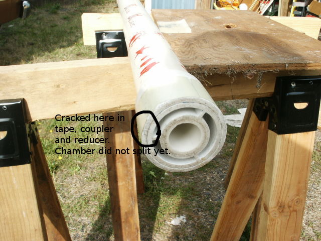

I don't have video, but I have had PVC fail. My Mouse Musket is retired due to a crack. It would have shattered if it failed at high pressure.spudtyrrant wrote: notice where it failed tho, i don't remember who posted it but it is somewhere on this site, he said the solvent weld had only been drying for 20 minutes before he shot it

The Mouse Musket got a crack when not under pressure and it was discovered while filling it with the new valve piston. It did not explode, but I quit filling it at 50PSI.
The photo is blurred, but the leak was at the muzzle end in the coupler and reducer. If this happened at high pressure, I am sure I would be sweeping the pieces.
