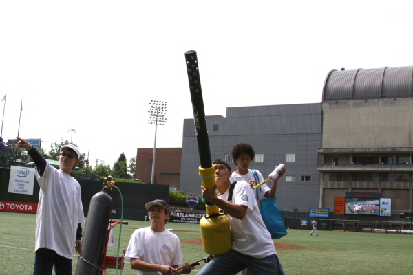

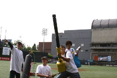

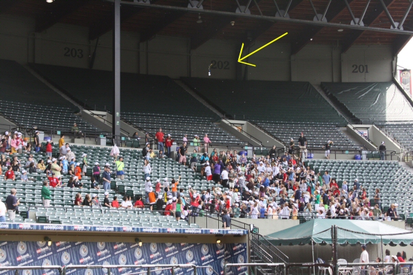

Attached is a photo of the Arlington team with the winning cannon putting a T shirt on the roof of the PGE Park at a Portland Beavers home game. It is 5 stories up.
Most made it into the crowd from home plate.
The launch
The launch
