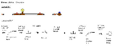

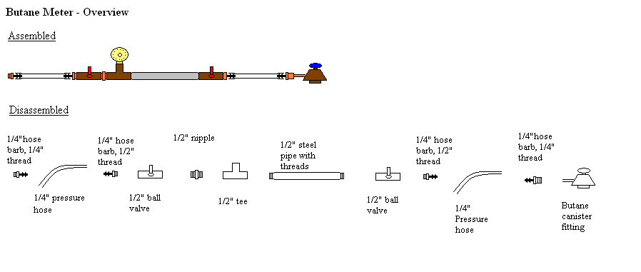

First of all I am fueling this on butane. Simply because it is easier for me to get, cheaper for me to buy, and from what i can tell you need slightly less fuel volume than propane (3.8% compared to 4.2%). It is going to be co-axial (barrel only runs 200 mm into chamber however) and I am using a fuel meter to inject the butane. I am using a barbecue piezo to ignite the chamber as a stun gun is hard for me to get. I'm not sure if a spark strip will work with a piezo (maybe not enough voltage?) but I am planning on testing a 5-gap spark strip with 1mm gaps. The launcher is is threaded where the barrel connects to the chamber so I can breech load it and it also has a threaded cap on the end so I can turn on a computer fan that i plan on inserting into the back. The butane cannister hangs below the chamber. The butane meter is hose clamped to the side of the chamber.
On the attached diagram of the butane meter its shows a 'butane cannister valve'. This is basically the top valve that i got off a portable butane-powered blowtorch. It shows on the diagram that a hose barb will connect to this valve; i will most likely weld this on. If the pressure hose fits nicely to the butane cannister valve i will simply clamp the hose straight to the valve, but it is not an issue.

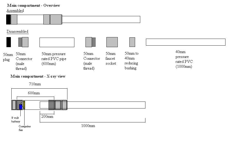

Specs
Chamber dimensions (diam. x length): 50mm x 600mm
Chamber volume (when barrel is connected): 1400cc
Barrel: 40mm x 1000mm

Butane meter volume: 90 cc

Pressure in meter (doesn't sound right to me): 9 PSI

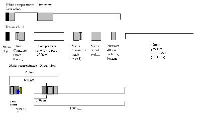

I have attached some of the basic sketches i did on paint (mainly for myself) but i will put them up anyway. Sorry, i think all the names for the parts are wrong but i originally just made these diagrams for myself but i hope you are able to understand them anyway!

Main Compartment
Main Compartment
Butane Meter
Butane Meter

First thought is why is this coaxial? There is very little space between the OD of the barrel and the ID of the chamber. It is in a hard to mix space and would contribute negligible power.
I'm in the US. I don't know the wall thickness of your pipe, but a 50 mm chamber and 40 mm barrel would leave a space of 5 mm on each side if the barrel has no thickness. Less when counting the pipe thickness.

Yes your right there isn't much space.
My only reason for going semi coaxial in the beginning is because i wanted to reduce the total length of the launcher without making the C:B ratio worse.
As i said i have little to no experience with combustion cannons and i thought 3-4 mm would be enough space for fuel to mix with a chamber fan going.
But maybe it's not enough space so i might have to reconsider. Thanks

Ahh, I thought your meter volume was 53.2, so I used that in my calculations. That was correct, but your new chamber volume is 785cc, so you'll have to re-do those calcculations
That is the correct volume of fuel, but I don't have enough information about your meter to check the pressure you need to get that value. (meter volume * meter pressure = volume of propane introduced to chamber).
The value you're getting (9psi) is measured in PSIG or gauge pressure. It is called this because it is read from a gauge calibrated to 0psi for atmosphere. Therefore, the pressure in your meter is 9psi above ambient pressure.
