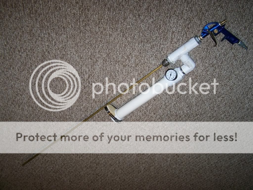

c11man wrote:thanks alot jimmy and tech.
73 shots seems a little low for how small my chamber is in my opion. but i could be wrong.
the number of shot will increase or decrease proporionaly with my chamber volume if i change it right?
Correct, except it's inversely proportional. Bigger chamber/less shots.
