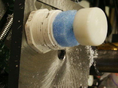

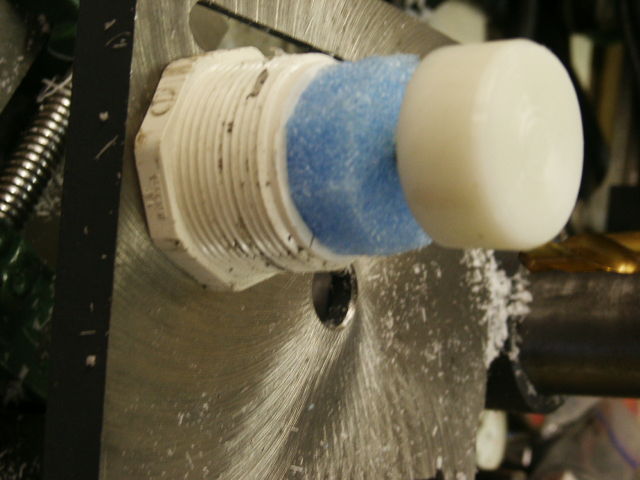

I added a bumper. I used two rubber disks on the back of the piston. These are the same disk which I used on the front as the seal. The first material I tried was some foam rubber but it collapsed when I opened the valve and plugged the hole. The piston is made of plywood and weighs 4.8 ounces. I lubed it as well with silicone grease. I didn't see any greater performance but I am a little cautious, only 80psi. It is a little louder though. Later on I will probably try a larger valve or maybe a QEV.

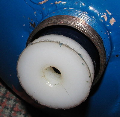

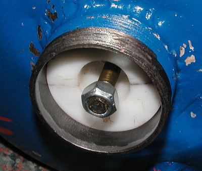

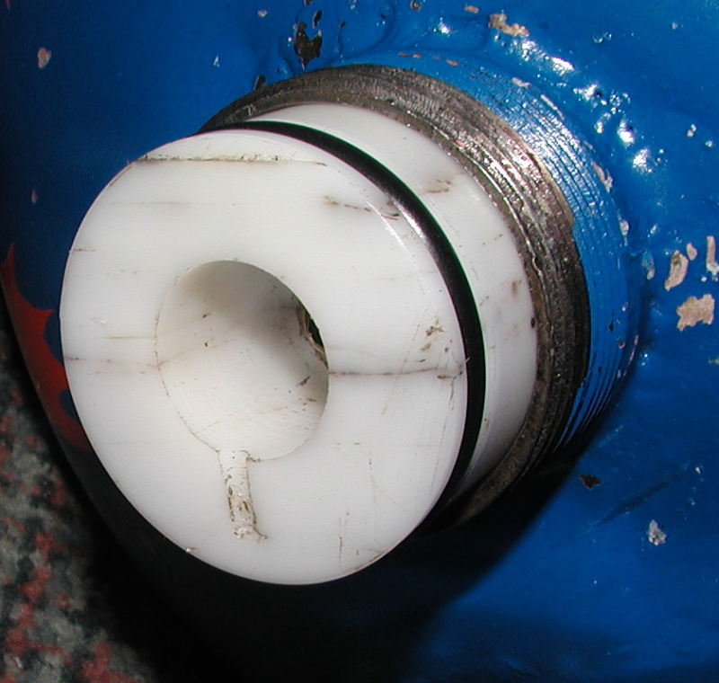

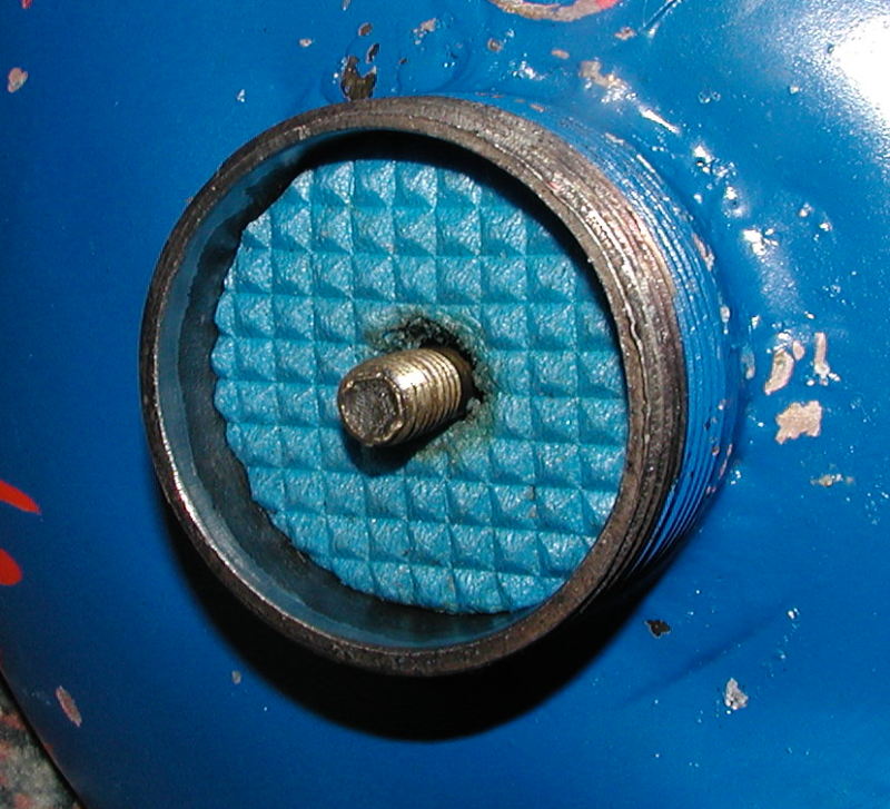

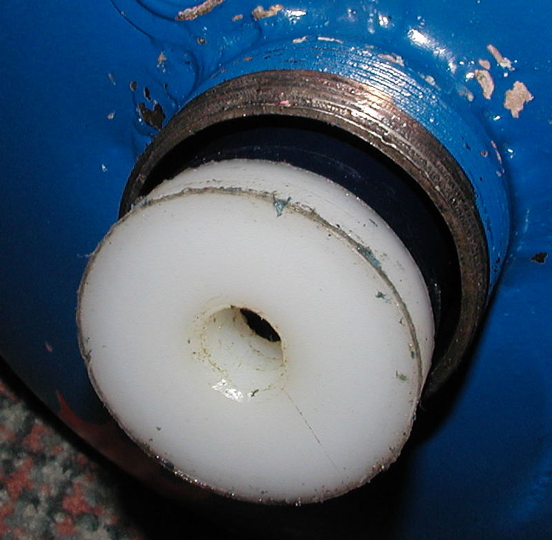

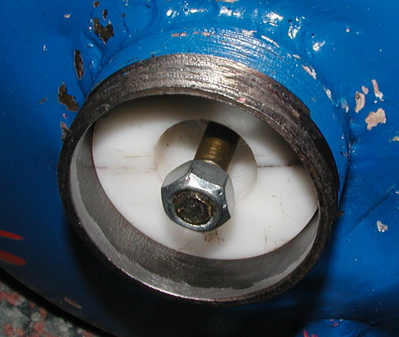

I have not had any trouble with this bumper style. The valve is not a traditional "Piston" but is the QDV piston. I have a series of photos of items as they load in from the muzzle end. This bumper has never blown out the Pilot hole. My large and small cannons use the same layout, QDV and traditional Piston.psycix wrote: Bumpers may be either attached to the piston, downside->heavier piston.
Or to the back of the T-piece, downside-> There has to be a free way for the air to the pilot valve
This foam bumper is cut from a garden knee pad. It is closed cell foam and pretty tough stuff.
The QDV has to be hand pulled open, which is why the bolt runs through it. The hole in a bumper and stop for the pilot would replace the bolt in a regular piston. A flat backed piston distributes the force evenly.
The Mouse Musket uses a traditional piston. The flat back and ring bumper are still used.
