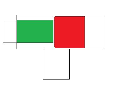

Crna Legija
Posts: 2333
Location: australia
maybe your piston is to small for the barrel port it should cover the barrel and still have some hanging over
green= barrel red=piston
neeewww, your not understanding my question, -_-'s picture describes my question perfectly. In his picture you can see where the barrel and piston seal directly in the middle of the tee. In the middle of the chamber port is best, that gives the piston a assessable surface for the air to push open the piston while the release of the pilot chamber creates a vacuum that pulls on the back of the piston.
The release of the pilot chamber works hand in hand with the chambered air to push and pull open the piston.
Looks to me like your piston meets the barrel at the end of the tee instead of the middle.
