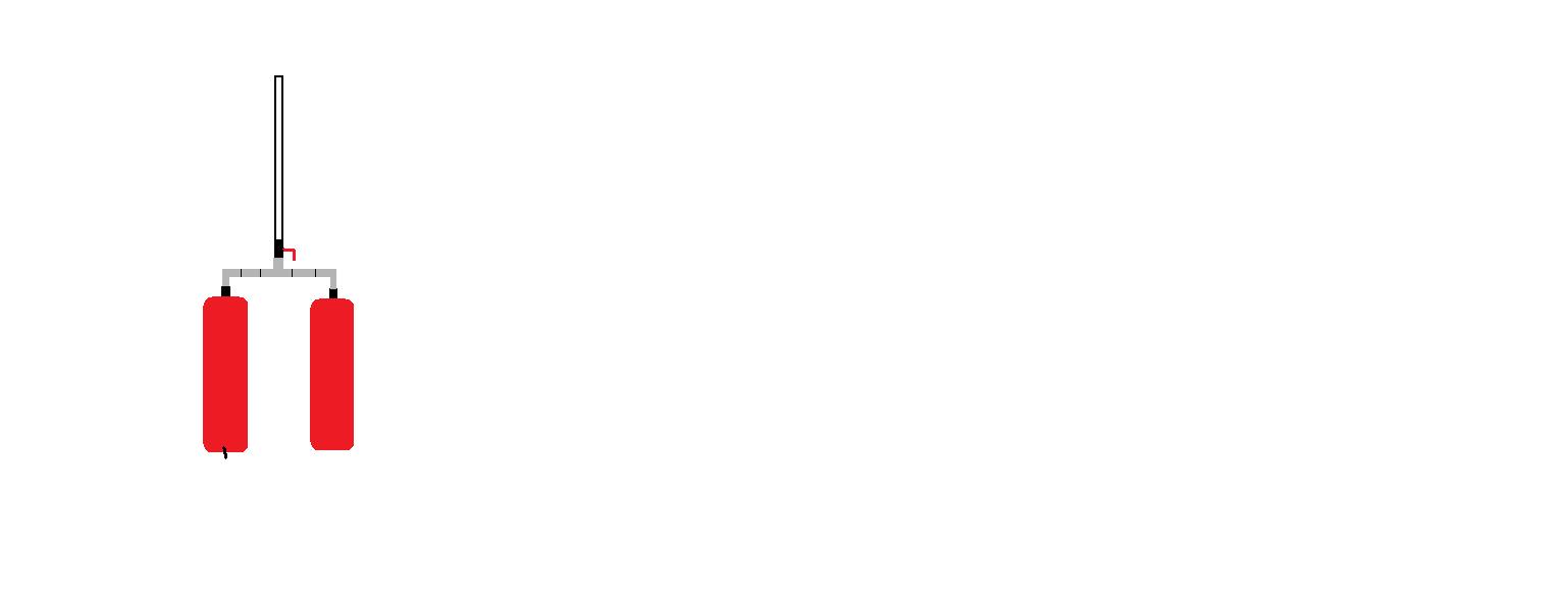

new spud cannon im deciding to make. consists of two small fire extingisher tanks which go to above 250psi each. two 3/4" nipples from these hook up to 3/4" 90 degree bends to 3/4" tee joint, which then goes to 3/4" tank valve then to the barrel. all of this allows for customisation and ease of use. all parts are pressure tested and galvonised. thinking about making size different but 3/4"will keep lots of pressure, and this also allows for barrel change going off the tank valve. pressure is the key issue as the fire extinguishers are the second smallest available but they hold high pressure. this design also allows for combustion and pnematic, when its made pics will be posted. just asking for advice on the sizes of fittings and anything else you can tell me will be great and you can also email me.
made from paint. not very detailed best i could do. any thoughts would be great.

loose the ball valve and get a modded sprinkler valve
and why not bump up to 1inch and instead of 3/4?

yeah sounds good. 3/4" was first thought because its cheaper and provides more pressure. thanks

i guess it really all depends what you are shooting out of it. if you dont need a 1 inch barrel then stick with the 3/4 and get a 3/4 sprinkler valve.

gonna shoot a whole range of stuff. thats why i designed it so its fully customisable (the benefits of threaded parts hey). probably out of smaller barrels big marbles and shaped potatoes. heavier stuff who knows.

You'll have to get the fire extinguisher tanks welded like I did, only cost $20NZD for me. If you're using a ballvalve i'd recommend taking it to higher pressures, around 350-400psi, because ball valves are pretty slow opening valves. Meaning you get poor performance compared to a faster opening valve such as a QEV, Sprinkler valve or Piston Valve. But a sprinkler valve can only handle about 125psi.
You'll also want a much longer barrel than you have in the picture. How do you plan on getting 250psi by the way? Just curious.

air compressor. plus my dad is a licensed pressure vessel welder so no prob there. previous spud cannons ive made worked fine with tank valve, and cos i wont have to by one makes it all easier but im open to options. and the picture is just a basic diagram overview not a detailed plan (obviously ).

and if your doin high pressure tanks and galvanized fittings then why would you use a plastic sprinkler valve that probably wouldnt be able to hold the same amount of pressure? id just make a spring assisted ball valve and use high pressures.
or you could build a metal piston or qev but from the looks of your design you want it to be pretty simple?

yeah simplicity and adaptability is main feature. yeah spring assited ball valve is what im doing, seems simple and can withstand the pressure. i also want this thing to last as well, sick of pvc its to weak.

also i dont want the fire extingishers weldied to gether although to make it transportable it loses it adapatabilty. i might also wanna have this with only one bottle or mabey three so it keeps my options open.
If they're not welded, they'd be epoxied. As far as i'm aware you can't get normal threaded fittings (NPT) that will work with fire extinguisher threads.
