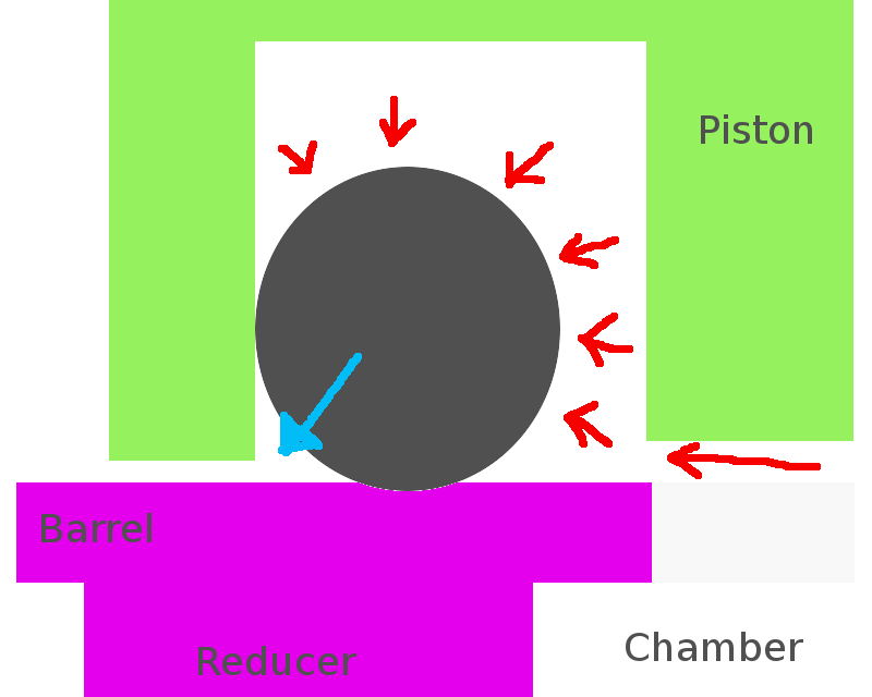

As far as the floating o rings, the forces on the rings needs to be understood. I threw up a very quick drawing showing a ring in a piston groove. I showed air from the chamber pushing the ring into the tiny corner where the pressure is lower.
From the drawing it should become obvious as the pressure increases, the force and therefore the friction increases. Large rings have large area, small rings have less area and thus less force. Unfortunately to get less force, tighter clearances are required to prevent the piston ring from squeezing out the gap.
Back to the very narrow ratio problem above.. It boils down to the piston may fail to open under high pressure. I haven't done any above 110 PSI so I can't speak for actual results.

Unless there is some way to retain the rings in the grooves, there is a very good possibility the pressure sealing the o ring against the cylinder will lift it off the piston as the cylinder wall drops away as the valve opens. Remember, air pressure is under the ring. For high pressure, consideration for a way to retain the rings on the piston should be given.

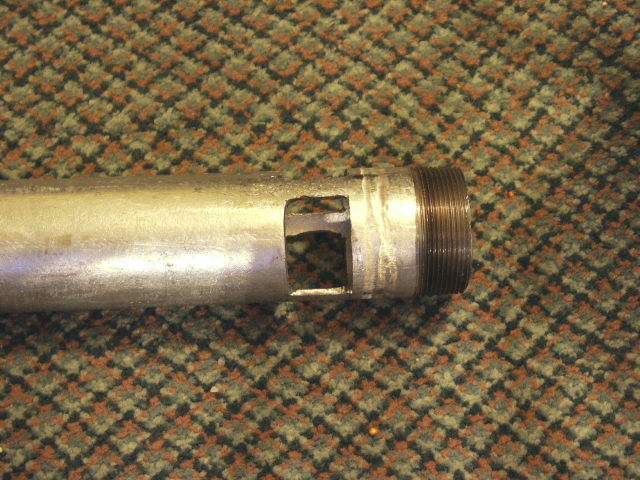

My valve has the 3 bars joining the front part of the pipe to the rear for both alignment and to keep the o rings from blowing off.

Valve ports for QDV valve.  The 3 metal bars keep the ends in alignment, the piston straight, and keep the o rings from coming out of the piston groove.
Floating O Ring forces from pressure
