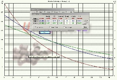

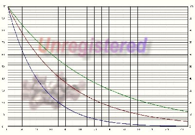

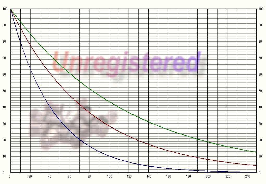

in the pic below I compared 3 different projectiles as far as their energy retention is concerned... (cd value is roughly 0.4 as they are all spherical projectiles
blue one - 16mm marble 5g
red one - 9.65mm steel bearing 3.5g
the green one 9.65mm lead ball 5g
seems pretty informative doesn't it ??

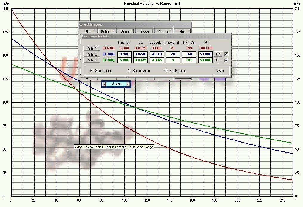

Is the distance in metres?
Interesting to note that a marble would have only 10% of its original muzzle energy at 100 of whatever those distance units are.

@jsr
yes the distance is in meters... the interesting thing about the graph I put above is that muzzle energy is completely irrelevant here (it draws the same graph when muzzle energy is 16J and 80 J; it's all about ammo used)
I've noticed that marbles lose their velocity quite fast but It happens to a greater extend than I though... notice that I put the muzzle energy for a marble at 100j and 50j for 9.6mm ammo
