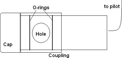

Hubb
Posts: 2390
Location: South Georgia
First off, you ain't gonna get 150 - 200 psi from a standard sprinkler valve. The pressure will be 120 max.
Next, to fire a 1" sprinkler valve, a 1/2" anything will do. A 1/4" anything will do.
As far as sleeve valves go, those things are pretty easy to make. Technically, this breech loader is a sleeve valve. Duplicate that to make it work for you.

Hubb
Posts: 2390
Hang on and I'll draw up a quick diagram. I'll edit this post when done.

colty-bear
Posts: 250
Joined: Tue Feb 24, 2009 10:24 pm
alright thank you then i need to find out what he hooked to the slide valve that rotated the track thingamajig that rotates the disk
it cant be ekactly like that because look how he is using it in this
http://www.spudfiles.com/forums/revosemi-t7694.html
and his is a flow and an exhaust
damn! i would just love it if i could just find one like his
