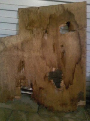

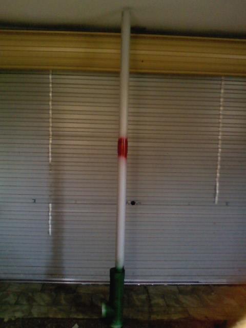

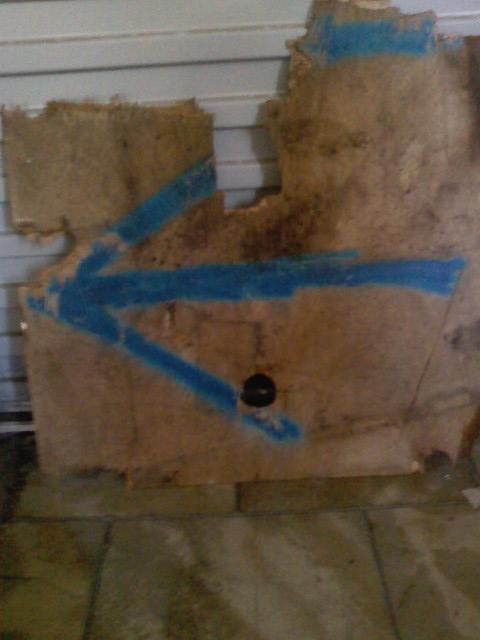

This is my 3rd cannon i built so far, its the biggest i built so far. I have test fired it with a deo can wraped in cloth (to close up the space) and it went through 3mm plywood like a hot knife on butter :D .

Cannon specs.
Chamber size; 100mm/4 inch
Chamber length: 470mm/18.5 inch
Barrel size: 65mm/2.5 inch
barrel length 2000mm/78.75 inch
the C:B ratio is 0.628:1 , i used spray'n'pray method. Hopefully i will find that 'start ya bastard' engine stater to get that little more kick he he he.

relativy simple cannon you have built there, im just wondering on how you would ignite the gas propellant? i pressume with a piezo ignitor?
other than that good work and i love the long barrel :)

yes i am usinga piezo igniter to ignite the stuff. Btw im not sure wether this cannon can take Propane or MAPP it's only made out of non-rated DWV PVC pipe so im not so sure.
Boy i tell you what im predicting to get least 300m with a tenis ball when i get out to a bigger area.

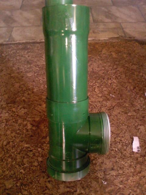

BTW when i fired the cannon for the first few times and i kept getting a light black coloured smoke coming a out of the camber when i unscrewed the cap off? does anyone esle get this :?: .

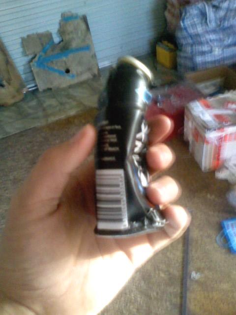

Oh here's what happend to the deo can

black smoke =incomplete combustion

Maybe i might install a fan to mix the air better with the fuel, i think this might eliminate the smoke problem

Chamber fans work wonders in spray-n-pray launchers. There is absolutely no better upgrade.
As far as propane / MAPP, well, I would stick with spray-n-pray on this one. It may hold up and it may not. Those aren't just DWV, they are actually designed for waste pipe (which means these are exceptionally thin).

well they hold for me, someone said to wrap it in cloth tape to make it stronger , is this true.
the label said it was DWV, but the wall thickness is (for the tee) 2-3mm the glued part is 3-4mm .
For best opinion i will ask my old buddy Bubba05 who i haven't spoken to for a while and he uses the same stuff as i do with the tee thing and all that.

if you wanted to strenghten the chamber,i would suggest looking for fibre tape, its strong as fuk and will prevent little shards of plastic exploding eveywhere.
