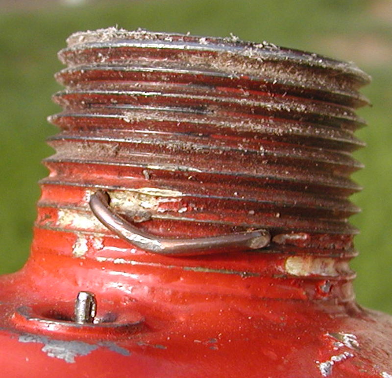

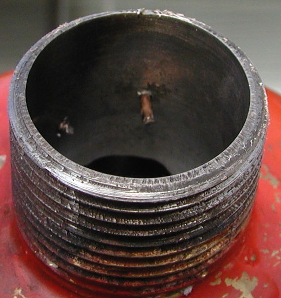

I had a close call with the t shirt cannon, but the rod, nut and pin on the rod and in the golf ball held and did not eject the piston. It did blow forward and bleed off the air out the back.
On the Marshmallow Cannon, Closing the valve too fast tended to set the valve too far forward and it would blow forward when air was added, but this movement always happens early at low pressure so the valve never ejected.
I drilled a hole in the side and put in a pin so that launcher can't do that anymore. I did that just before it was lent to shoot t shirts so there would be no liability accidents. The primary reason was for reliability so the valve would close properly every time so the people that borrowed it would not have to wait for the pressure to bleed off to re set the valve. Safety to eliminate the possibility of an ejected piston is a secondary benefit. For me it is obvious to stop adding air when it was hissing out the back when filling.
Edit; added pictures.
The piston normally stops just short of the pin, but if someone slams the valve closed it hits the pin, still too far back to unseat any o ring.
A welding rod was bent and the ends pushed into a pair of holes.  There are no sharp points outside.  Yes the piston end rests this far forward for a small dead space.
