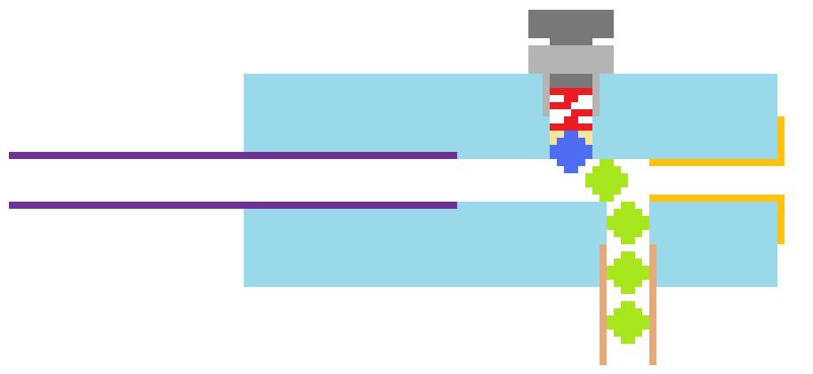

Will this work as an auto system?
the orange is a blowgun
the purple is the barrel
the grey is a adjustable hopup/bb holder
the bb are spring fed
the only problem i can see is that the bb's in the magazine wont come out when pressure is applied.
oh and i don't wand to build a vortex type because there seems to be no real good way to bring the rof down, or is there.

If the BBs are spring fed, it should work well, it's pretty much what Davidvaini did here.
The biggest issue I see is that unless you're using a ready made airsoft mag that's sealed airtight though, it won't be easy to make a high capacity magazine.
Use a tubemag.
You could also put a small air feed on the back of the tubemag to push the bb's.

ja holland owned. @psycix weet jij waar je in nederland aan een 6mm buis kan komen?

R/C hobbystores hebben t, maar daar is het duur. Je kan ook bij de bouwmarkt kijken. Anders kan ik nog wel iets voor je regelen, maar volgende week weet ik pas of daar ook BB's in passen.
