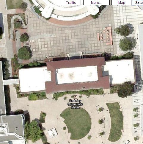

Where is that building located? It looks familiar.

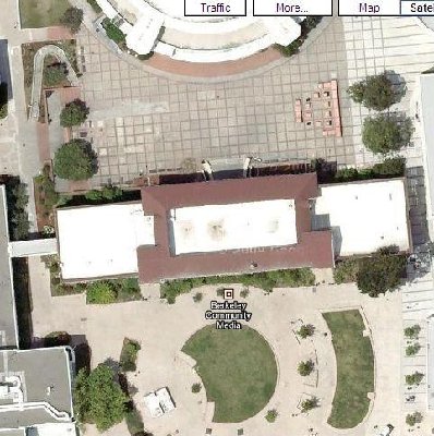

Edit, According to Goggle maps in the Satellite view, the building is about 75 feet across. I thought I had seen it before. :D
Bonus points on how the photo was taken. Most likely a helium balloon or RC aircraft. Due to the clarity, I would guess balloon.
Top view of the building
