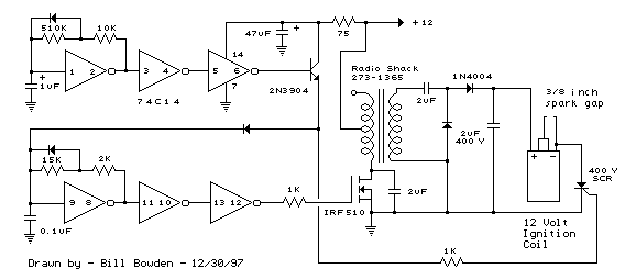

FYI, Disposable cameras charge to about 250-300 volts. To match the energy in a CDI car ignition, changing the cap and charging it the same will produce the desired result. And yes the cycle time is much faster.
In this online schematic, a 2 uF cap is used and charged to about 340 volts. A cap around 1/2 uF works OK to produce a spark like an electronic BBQ igniter. The 2 uF at about 300 volts will often spark over the coil tower to the primary connections if a spark plug wire is not inserted.
http://www.circuitdb.com/circuits/id/164
This other schematic I just found does use a cap in the range of a 1/2 uF.
My first home kit built CDI I used on my first car was similar to this. I built one in the late 1970's.
- CDI schematic found online.
