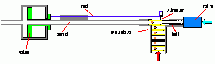

Basically what I tried to achieve here but without much in the way of power. The solution would seem to be to extract the cartridge after the projectile has left the barrel, as opposed to the blowback solution I was pursuing.
Here's a design I thought up, combining cartridge feed with a gas piston similar to how the FX Monsoon works. Obviously the rod in this case would have to be at the side, it is illustrated on top for clarity. It would be opposite the ejection port, and along it there would have to be a structure that the cartridge strikes in order to tip it out.
Not the simplest of projects but probably workable, hmmm...
