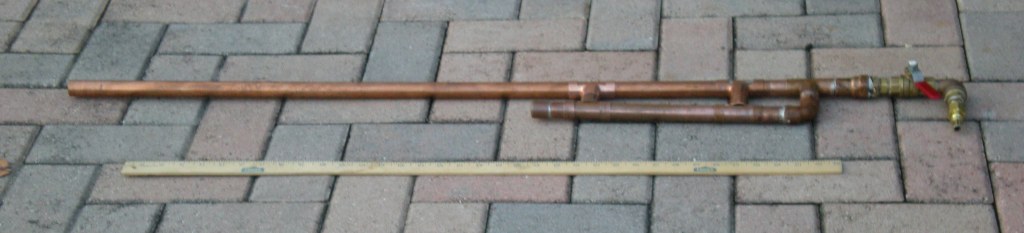

Here it is:
The new piston and the new seat worked the very first time.
I have the recipe if anyone would care to try to make one.

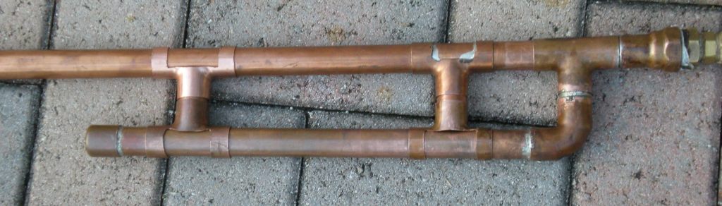

In this new gun, the barrel fits directly into the valve T.
It goes in a little over 0.6" and therefore I can load a dart with just a 3/4" bolt throw.
I can use the chamber end cap as a slide stop.
I discovered a problem.

I have shot it at 300 psi and the 0.6" fitting insertion depth plus the dual T's have enough friction to hold the barrel in place.Brian the brain wrote:Nicely made!!
Does it need a spring to keep the barrel in place when shooting?
Surprising.
What it means is that you can do away with a bolt if you design your gun along these lines.
I have been shooting 110 grains at 500+ fps.
A 3" 10d nail goes through a thick telephone book and the 5/8" plywood it is attached to.
Very powerful!

Another possibility is to 'play' the Trom-Boyn as you shoot, placing back force on the barrel.
So far unnecessary.
Darts are easily loaded and it shoots very well.
Onr additional benefit to the slide load is that you can look down the barrel to check for fouling.
My sequence is:
Slide open the barrel to the side.
Inspect the barrel.
Load a dart.
Pressurize the chamber.
Insert the barrel.
Shoot.
A bonus of the slip T design is that barrel can be removed and the 'plumbing supplies' can be carried in 2 pieces.
