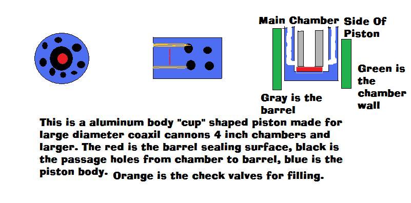

Cup Shape Piston
The basic idea came about in talks with Rabidduck about a 4" chamber coax cannon he's building. Because of the need/want to keep pilot chamber small and possible piston tilting with large diameter pistons, I thought the majority of the piston could be in the chamber.
This way the piston can be plenty long enough to avoid tilting and still have a small pilot chamber. The part of the piston in the chamber will be hollowed out to allow plenty of flow and keep weight down. With enough surface area to do the job.
I'm sure there is plenty of things this piston can be made from.
Anybody think of this before? I haven't seen anything like it myself, but that don't mean it's not out there all ready...
Updated
Updated
Updated so it's easier to understand.... :D

a better way is to take a flat cap and face it so the socket side is pointing towards the muzzle end, the sealing face would then have to be bolted to the inside of the cap

JSR that's close but not what I had in mind.

Have you checked the fit in your chamber with this yet? If so, how snug or loose is it?

Sounds about right. How are you planing on making the barrel hole? Get it in the center...looking good so far.

As for length work with what you got. Do you have a drum sanding bit you can put in your drill? Use a piece of 2 1/2" pipe and trace a guide line around it so you have something to go by.

The only problem with using a holesaw is it's just going to cut a circle. It wont remove the fiber glass out of the center. Remember your not cutting all the way through, just 3 inchs deep.
