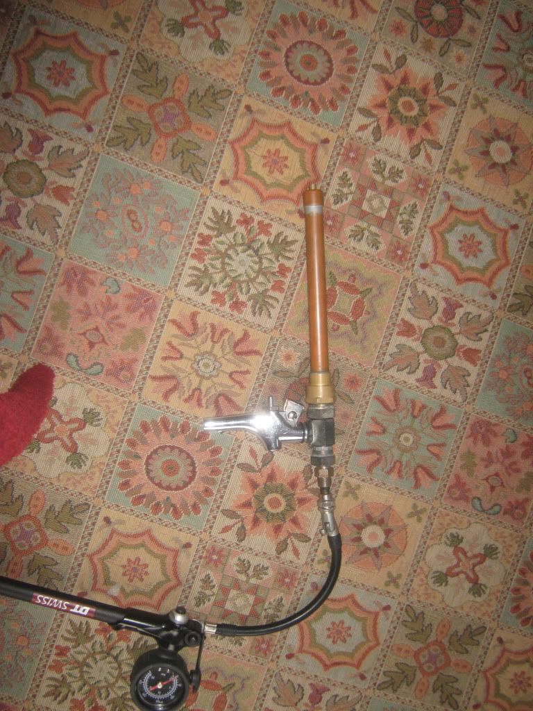

I am working on a piston valve, piloted by a blow gun.... the gun is just under a 18 in but it has a 12 in barrel... the total length minus the barrel is that of a 1/4'' T and a 1/4" elbow with a 1/4'' close nipple in between.
Just took it upto 250psi. louder than your mother after the dog pees on the floor.
Like mine? i just used 15mm copper coaxail and i get very nice results with an O-ringed piston at 200psi i get 500fps +. But this is very old(3 months) and i didn't bother posting it. Overall it's very fun, loud! and easy to service. ( i can hand open and close everything because i just use o rings.)
