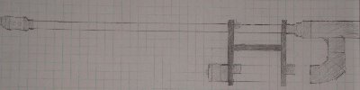

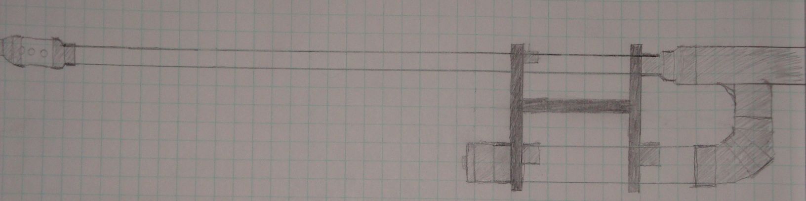

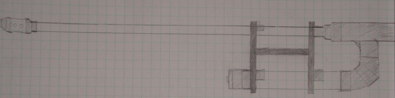

The pipe comes in today for our largest build. theLesser and I have been designing a howitzer type gun for the past few years and have just now accumulated the resources to build it due largely in part by NGO's (such as friends and relatives sending Christmas gift cards to home improvement stores and such). The massive 6" switchback design chamber has a tremendous 1494 cu. in. volume. Combine that with a 10' long 3" barrel and you have a gun with roughly a 1.6:1 C:B Ratio. 500,000 volt stun gun ignition using a quite similar spark strip design Starman used in Triple Thunder. Using propane and/or MAPPro as fuel, and having dual chamber fans, we hope to fling water filled coke bottles and sabot ammunition as far as we can. Breech loading seemed necessary for a switchback design. We've sketched things out, made scaled down mock ups, gathered scaled down recoil data (for which we've accommodated), and have tested the 12v switch box and ignition system. Pics to come later today of designs, specs, switch box, and of the gun's chamber pieced together.
Here's an an early scale drawing.

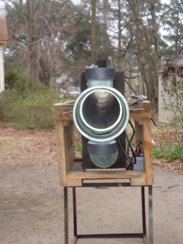

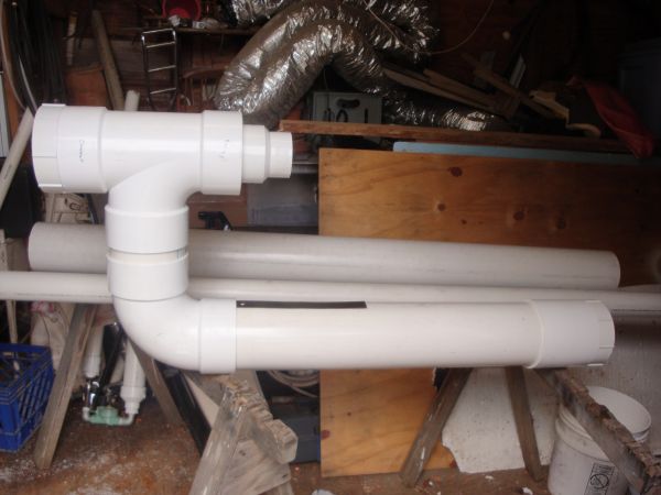

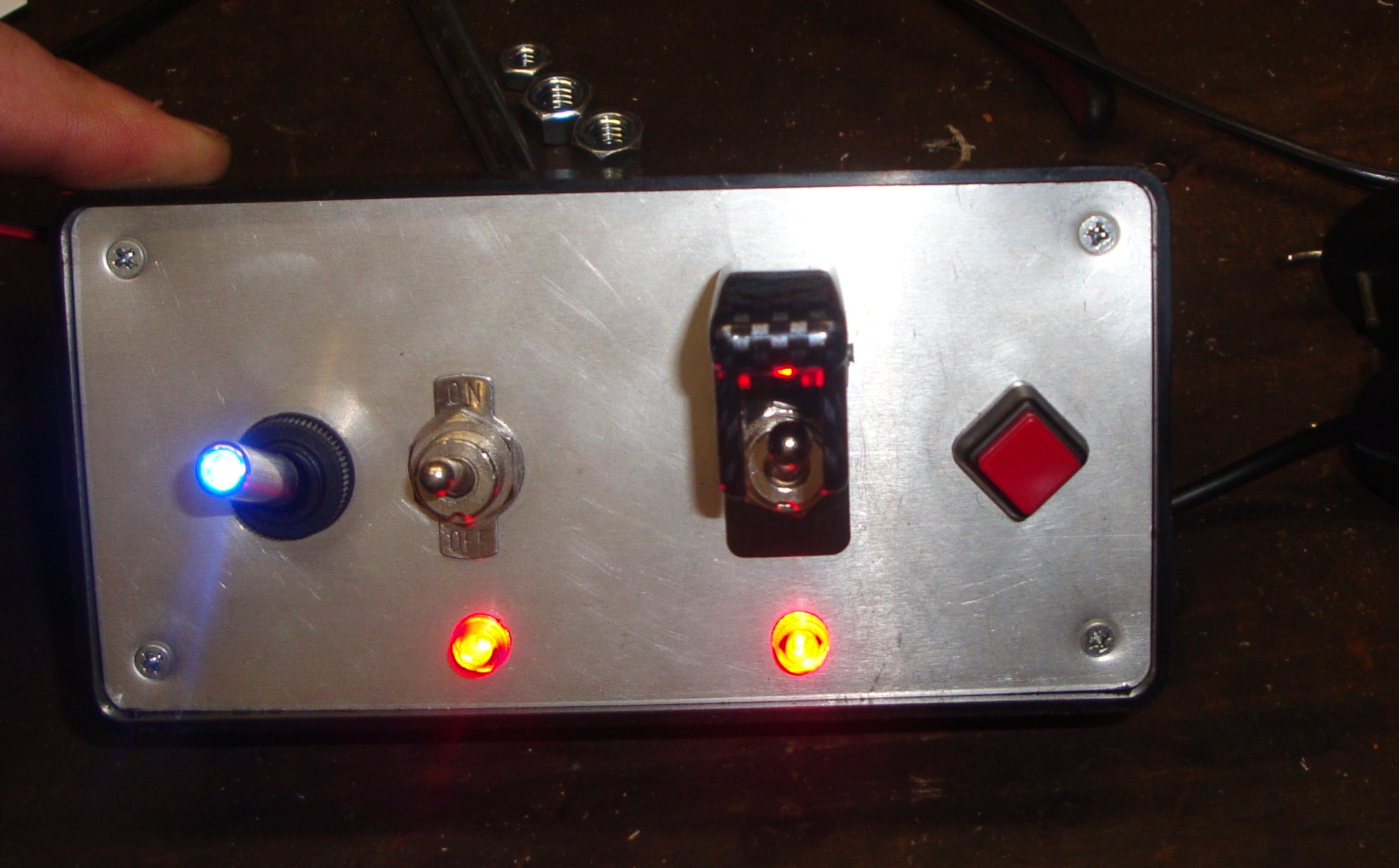

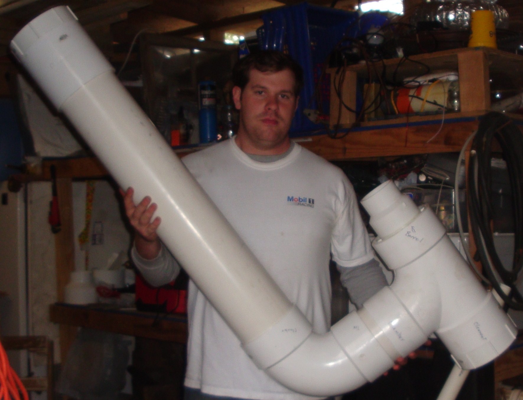

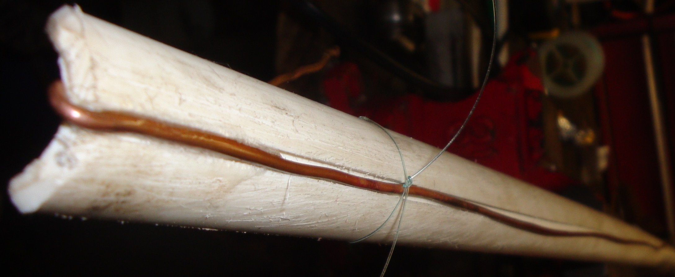

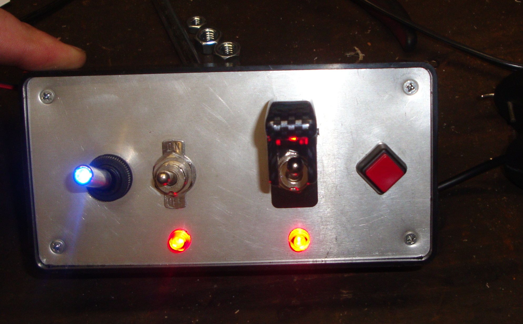

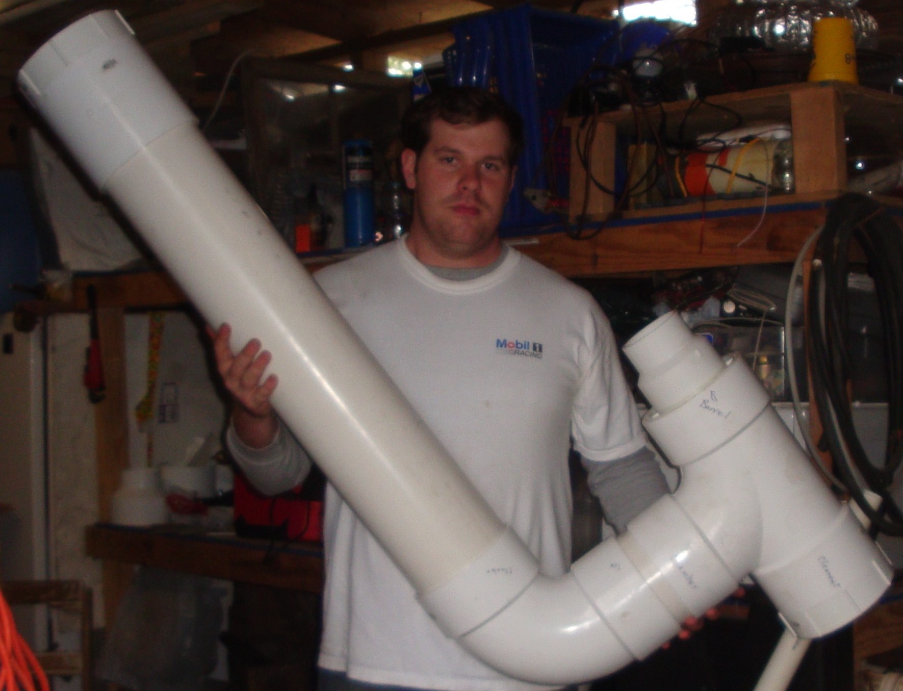

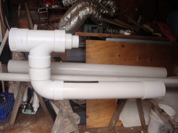

So here are some pics for your spudding enjoyment. We haven't got the spark gap in yet because we're letting the epoxy cure before we do any kind of machining to the gap. The "T" is also not connected for this reason. Does anyone know of an easy place to resize images online? The one I use takes a long time and I can't do multiple pictures.
Putting a face to the name (and scale to the pipe).  I'm 6'2.
Switch box.  The switches are as follows:<br /><br />Main Power (with the blue LED), Chamber Fans, Arm switch (with cover), and Fire button.
Starman-esque spark gap.  Waiting on epoxy to set.
12&amp;quot; ruler sitting on top of the chamber for scale.
12&quot; ruler sitting on top of the chamber for scale.
Looking good, the switch box is a particularly nice touch :)
McCoytheGreater
Posts: 191
Joined: Tue Dec 15, 2009 1:10 am
Location: Mississippi State
Thanks! We're using RCA jacks to hook everything up. theLesser hooked everything up inside the box. There's a relay that powers the stun gun so we don't get any feedback into the box itself. Also, if anything shorts out inside the box, the relay won't work and the gun won't fire. It's pretty nifty.
