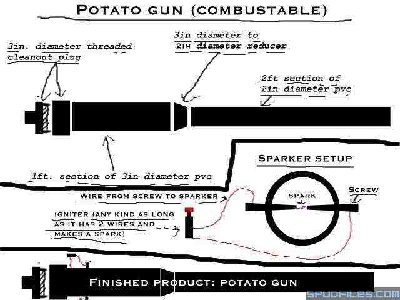

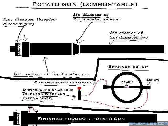

This cannon design is your basic combustion. If you haven't read the theory page then I advise doing so before building a cannon. I go over safety precautions and safe, effective building tips as well as how it works.
You will need the following for this project:
3' or 4' of 2" PVC (make sure it is SOLID white pressure rated, schedule 40 or higher). This will become the barrel.
1' or 1.5' of 3" PVC (same as before, must be schedule 40 or above). This will become the chamber
One 3"-2" reducing coupling (reduces from chamber to barrel).
One female 3" threaded coupling (this will attach to the end of the chamber).
One 3" clean out plug (this will fit into the female threaded coupling and complete the chamber).
One standard BBQ grill peizo igniter (can be purchased at any hardware store for around $5-$15...). this will be your ignition source.
2 screws which will conduct a spark and when screwed into the chamber allow a gap small enough for the spark to jump across.
One bottle of Right Guard.
One sack of potatoes.
Have fun, be careful, and enjoy.
Provided By Devin - <a href="http://www.cherryspotatoguns2.150m.com">www.cherryspotatoguns2.150m.com</a></div>
Sorry for the poor quality of these plans... They are old plans for my first gun and I haven't taken time to draw up new ones. Actually, I haven't really made time because these get the Idea across fairly well.
Finished product is above: I do not advise placing the wooden stock on the end cap as I did. I did this before I became aware of the compromise of safety this caused. I do not advise screwing any more holes in the chamber than absolutely necessary.
