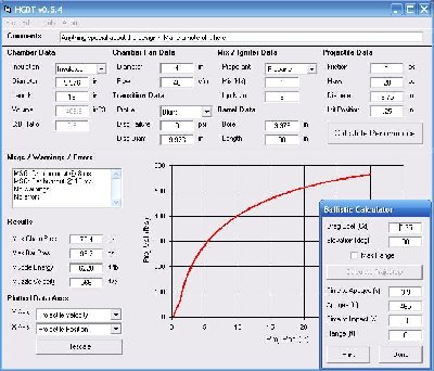

JSR tends to build on the smaller side, but for those of you with the benefit of land over which to shoot, why notGun Freak wrote:JSR wants it...
