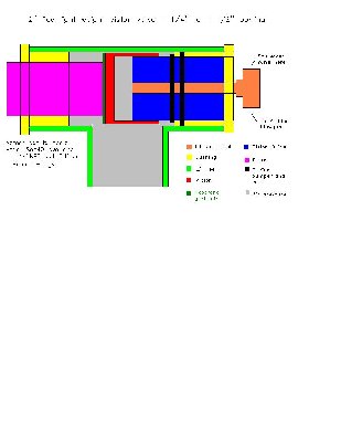

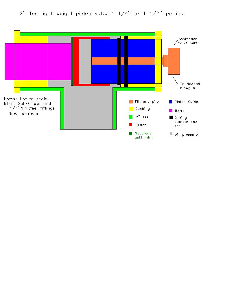

c11. sheet product would have to be pretty thick to withstand the pressure....and the piston impacts, which would be pretty substantial at 300psi.
I'd use a reducer bushing...something like this;
http://www.aquariumsupplies.co.za/image ... 37-338.jpg
I'd use it something like this;
Edit: I see you know it'll need to be thick...damn wasted time searching for pictures.
i want to avoid a actual fitting if posssible for several reasons like how the stock is going to atttach, ease of oring machining etc..... i would make the plug out of the same pvc rod that i am going to make the piston out of and it comes is 1ft sections so i will have about 8inch of the rod left over. so i can make it as thick as i want! now how think will i Need it to be?
