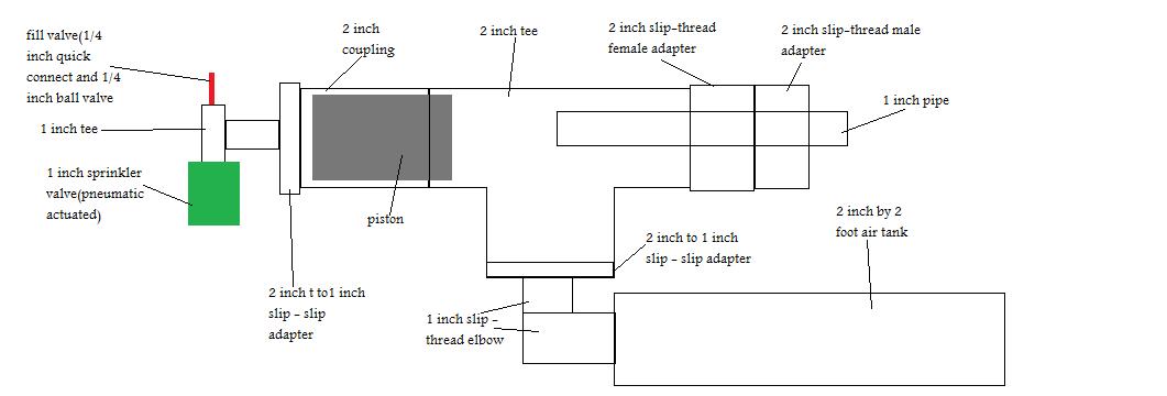

I recently built a 2 inch piston valve with 1 inch porting. The tank is screwed on via a 1 inch slip to thread adapter. I use a 1 inch srinkler valve as a pilot valve (This one's an Orbit Watermaster). I used a 1 1/4 inch coupler as the piston and filled it with epoxy. When I fill the gun with air, everything is airtight, but when I release the pilot volume, the gun's performance is less than impressive. It can still shoot a spud, but right now I'm getting better performance out of a cannon using a 1 inch sprinkler valve
I'd post pics of it, but I'm way out of state for the moment. What should I do to improve performance? I was thinking that having air flow through a 1 inch hole twice(once to get out of the main tank on the gun, and again to get out of the cannon) was messing with performance, but since this is one of my first kind of successful piston valve air cannons I'm not really sure.
A diagram of the internals would be helpful. How tight is the piston in the tube it travels in?

It's a pretty good fit. Probably not the best, but it's pretty good. I'll try to make a diagram of it ASAP
Try wrapping it in tape until it's tight enough that you can barely move it with one finger.

Anyways here's a very rough drawing of the gun. I used the design Klugeboy demonstrated in one of his videos on youtube. It's in part 2 of his piston valve videos.
on the diagram I have a 1 inch slip - thread adapter at the end of the 1 inch pipe so I can screw on barrels.

If its hard to move then it wont open at lower pressures... right?
If you could make the piston move easily but seal 100% with O rings you'd have a real winner
Unfortunately if the piston moves easily it starts to leak air around itself.
You really got to balance adequate seal and ease of movement the hard way... Or a floating O ring design maybe?
Unless your piston is ridiculously heavy, the only reason I can see for poor performance is a loose piston fit.
He's already done his homeworkc11man wrote:how long is your piston travel?
Metalcookie
- Private
- Posts: 14
- Joined: Sun Mar 07, 2010 3:44 pm
The piston isn't very heavy, and it travels about an inch. Like jackssmirkingrevenge said, I've already done mah math.
The piston has a far from airtight fit, and when I exhaust the pilot volume, there is quite a gust of air coming out of the sprinkler valve.

Try rebuilding the piston with a lighter material. Thats what I would do...

How light should the piston be? It's not heavier than a wooden piston of the same size.
Wrap it in duct or masking tape as suggested earlier and see if it makes a differenceMetalcookie wrote:The piston has a far from airtight fit, and when I exhaust the pilot volume, there is quite a gust of air coming out of the sprinkler valve.

Jack it might just be too heavy, ya know?

True, but in that case a loose fit isn't helping.Gun Freak wrote:Jack it might just be too heavy, ya know?
