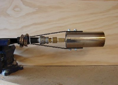

To explain the attached pics:

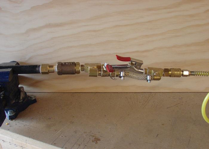

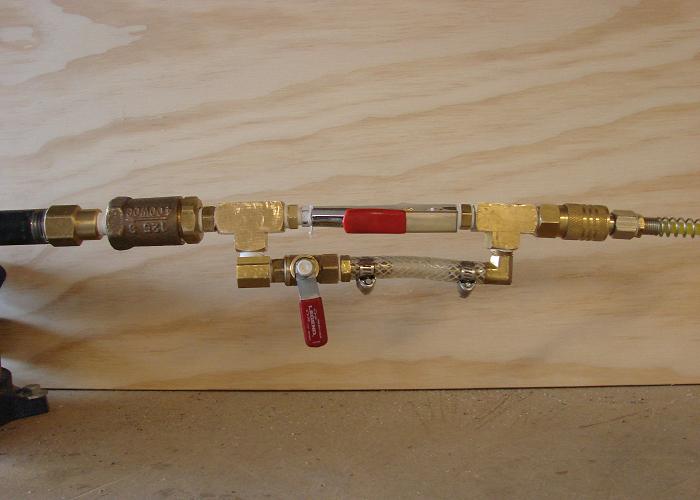

Propane (from a BBQ tank) bypasses the blowgun, through the first tee.
The mini-ball valve leading into the second tee, is to regulate the flow and is used simply for starting and to allow the torch to go back to an "idle".

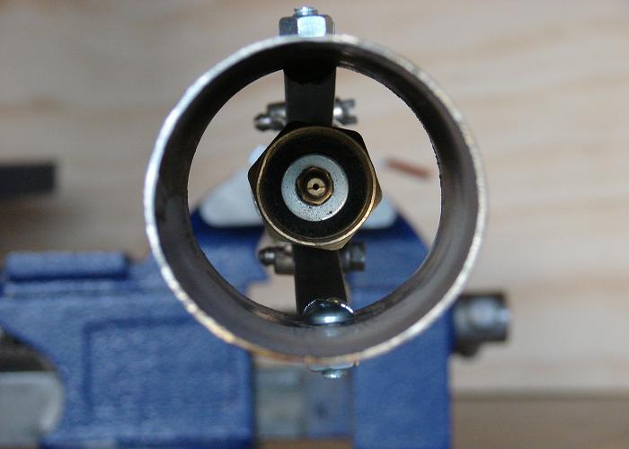

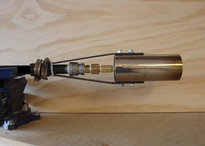

The blowgun plumbs full-pressure gas into the torch wand, which is a 1/2" NPT x 24" Black Iron Pipe Nipple. - Simply squeeze the trigger to get the monster flame.
Not exactly the safest setup, as (I'm sure) that the blowgun was never meant to plumb propane gas. The store-bought propane weed burners, IIRC, are regulated to about 30psig max.
The shroud is a piece of 2-1/2" Chrome Exhaust Pipe (which, actually, used to be part of a turbo setup on some rice-burner type car).
I originally had the "jet" about halfway into the shroud, but to get it to sustain a full-pressure blast, the shroud position had to be adjusted.
If I had bought all these fittings though, it would've cost me 5 times as much as the chintzy one from Harbor Freight. All-in-all; it was just a fun project.

Haha, looks fun. One little word of warning though (you may already be aware of this), with that type of blowgun (at least, the one I owned) whenever it was depressed and gas was flowing, some gas would leak out of the little shaft sticking out the side which the lever actually pushes against.... so basically, there is a potential for a largeish flame to erupt from the blowgun itself if an ignition source gets close enough. Luckily, releasing it will stop the flow and should leave at least one of your eyebrows intact

To fix this untread the valve assembly, out teflon tape on the threads and thread the valve assembly back in to the blow gun. I did this to my blow gun last ight and it no longer leaks. Be warned though that worn seals could cause a leak that could release some of your gas.Insomniac wrote:Haha, looks fun. One little word of warning though (you may already be aware of this), with that type of blowgun (at least, the one I owned) whenever it was depressed and gas was flowing, some gas would leak out of the little shaft sticking out the side which the lever actually pushes against.... so basically, there is a potential for a largeish flame to erupt from the blowgun itself if an ignition source gets close enough. Luckily, releasing it will stop the flow and should leave at least one of your eyebrows intact
