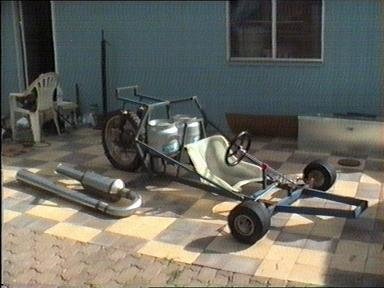

Nice running engine :P I made one many years ago, in fact while I was away at university I made the <a href="http://www.spudfiles.com/forums/brass-h ... l">harpoon gun</a> the first year and the pulsejet the second, something to fill in my time that judging by my grades would have been better spent studying.
Though unlike the gun this engine never worked! I got way ahead of myself building the trike before seeing if it even worked, it was designed to fit two of them. Though I never really tried to tweak it, the engine dimensions themselves should work as its based off the original lockwood hiller patent, thinking the fuel nozzel was at fault.

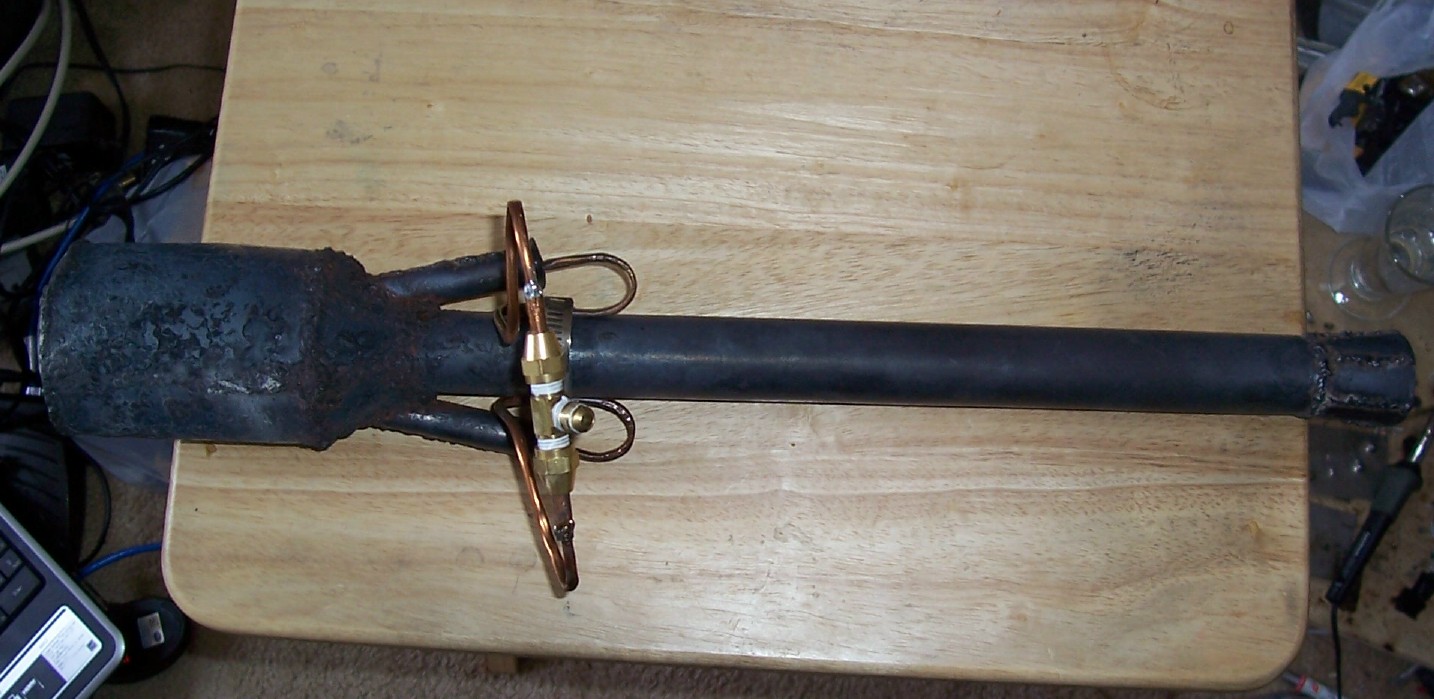

Edit: Finished, the chamber is 40mm (id), and the whole thing is around 30cm long. It's in a similar configuration to yours. It still needs a spark plug and a fuel setup.

That's an AWESOME-looking trike design! Too bad those components weren't sitting in my garage, as I'd have it screaming down the street, by tomorrow!- Ha!
I've seen a LOT of videos on youtube, with people having a LOT of problems, getting their lockwood-hiller to start... It's ALL in the injector, as you've implied.

Well, I got my camera out and snapped some photos of my jet. Granted, it's absolutely tiny next to yours and will be tricky to get working- but should be a fun novelty. I used (copied) your design- it seemed like a good one to execute on a smaller scale where making a bend for a Lockwood-Hiller design would be difficult.
It needs some cleaning (probably a quick dunk in a bath of HCl) and the sparkplug added..but it's essentially done. By the way, the front looks weird because it's made of checker-plate.
Oh, and...
Initial plans are to get it running on propane- though it would be excellent to get it to run on liquid fuel. Assumedly that will be substantially more difficult than even getting it to work on propane- but we'll see.

Edit: Wow, I expected to have a massive fight to get the sparkplug in the chamber..I was thinking I would have to go to the extreme of welding it in there or something. Turns out I can just run an M14x1.5 die over them. This cuts the threads a little differently, but results in only very slight thread loss. With a washer it should still seal fine.
