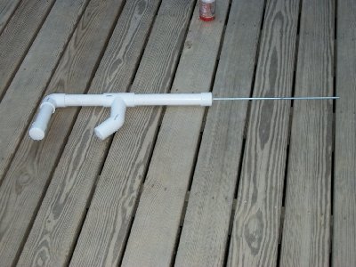

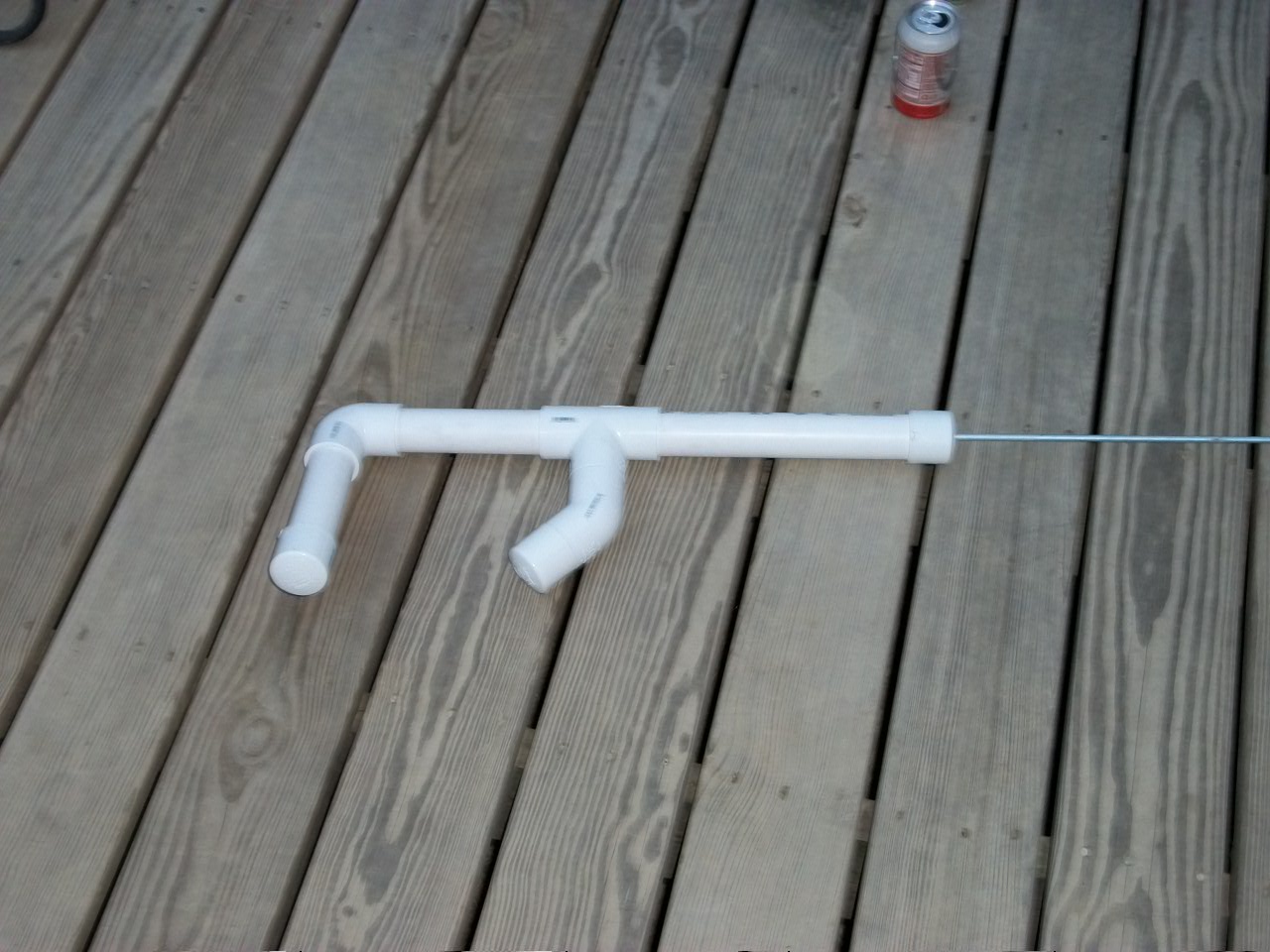

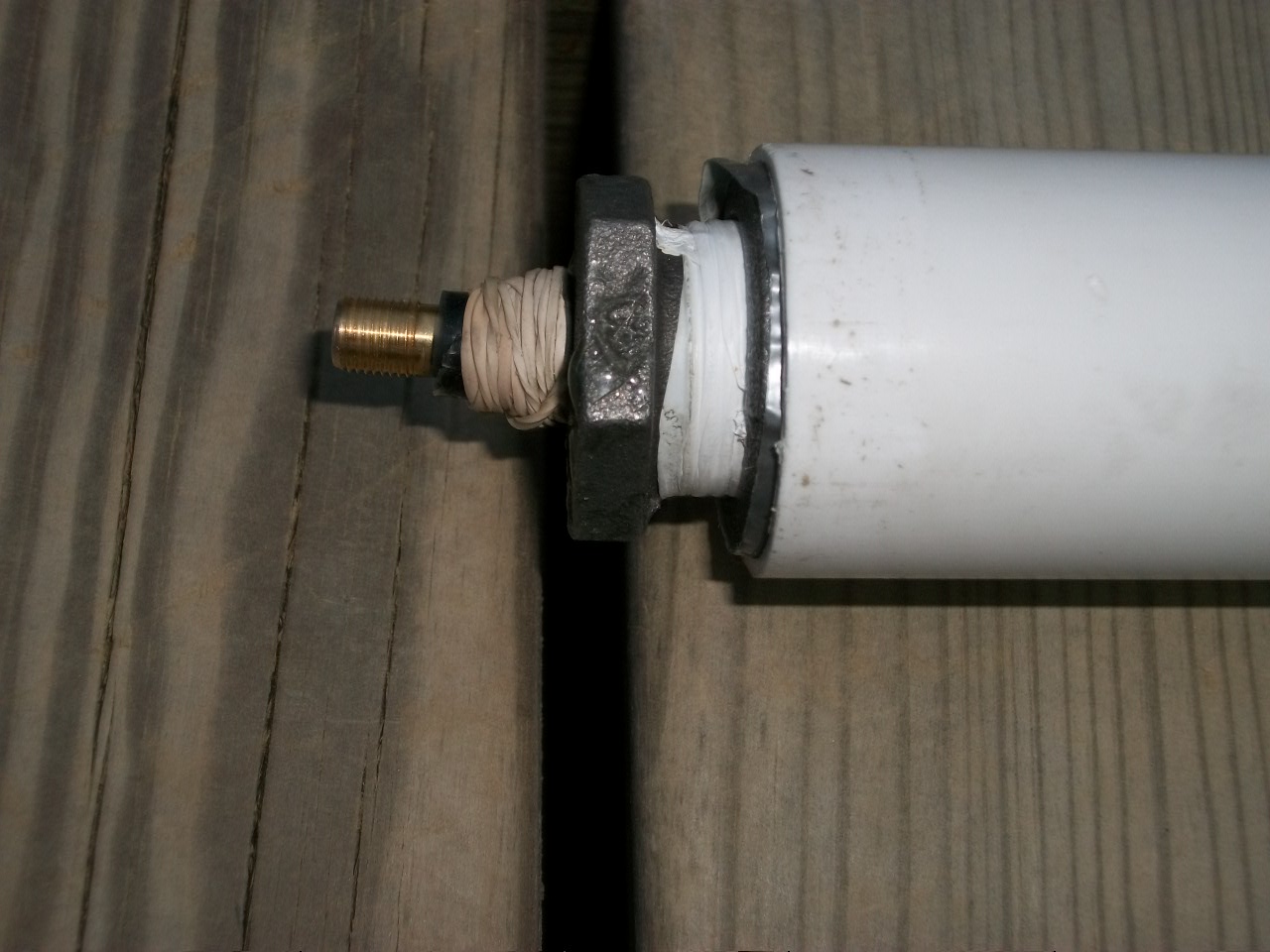

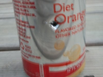

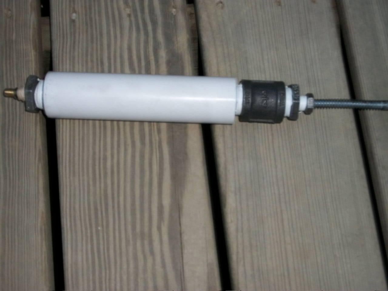

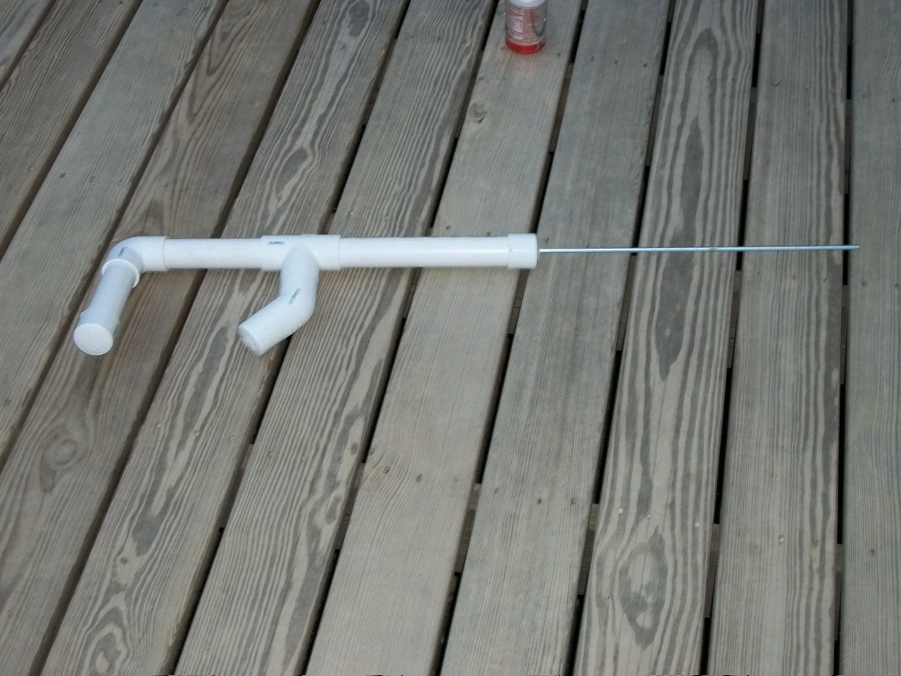

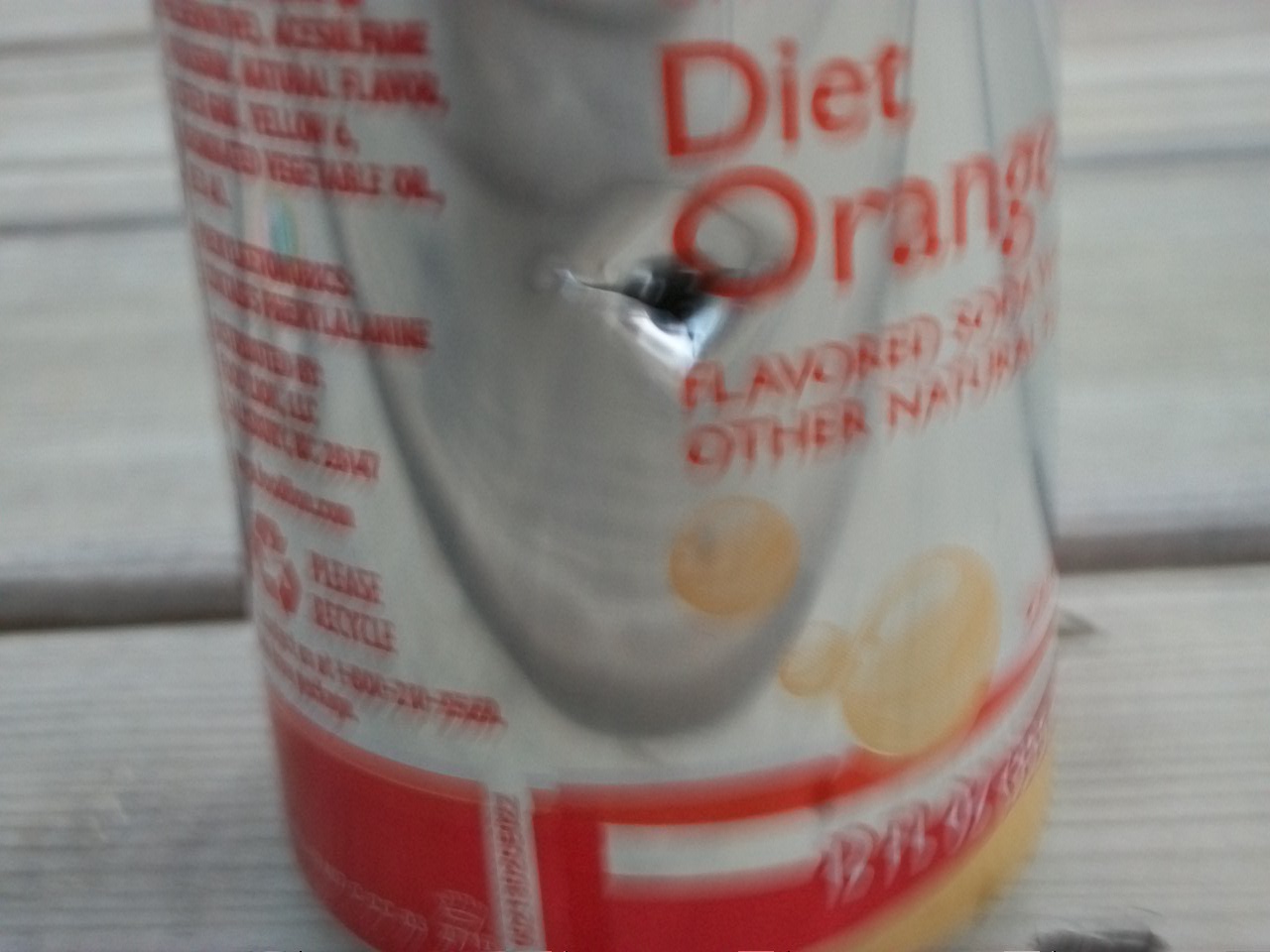

Heres my second version of the pellet gun I posted earlier. The main improvements are a stock made from thin walled PVC, a larger hole for the valve and the hole closer to the o-ring. This version is slightly more powerful and much easier to aim. So far Ive been able to hit a coke can from 20 feet with ease and have not tested any further. I have a video and will post it as soon as it finishes uploading.

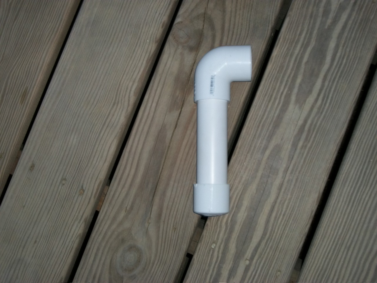

Heres V1.
http://www.spudfiles.com/forums/metal-b ... 20487.html

Looks better now. Paint would make it look even better. Good job.

Thanks, Im going to try to find some krylon fusion this weekGun Freak wrote:Looks better now. Paint would make it look even better. Good job.

I still don't understand your firing mechanism

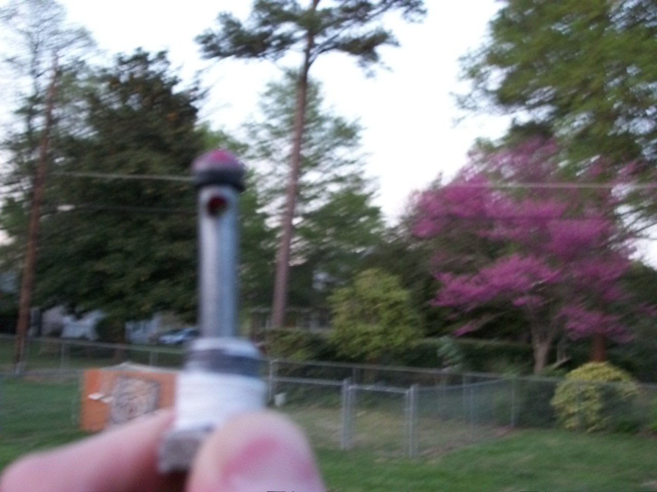

well the barrel is plugged at one end and when its pushed down a hole is exposed in the air chamber, I may make a video demonstrating itGun Freak wrote:I still don't understand your firing mechanism

Oh ok so its like the xrv
- clemsonguy1125
- Sergeant 5
- Posts: 1485
- Location: East Coast
yeah, I based it of that one, I just added a chamber and a way to remove the pumpGun Freak wrote:Oh ok so its like the xrv

It is except drilling a hole through the barrel, its a pain, the larger you make it, the harder the barrel is to push back, I made a model with a 1/2 inch barrel and I could not fire it at anything above 20 psiGun Freak wrote:Yep. I think I might make something similar. It seems easy.
