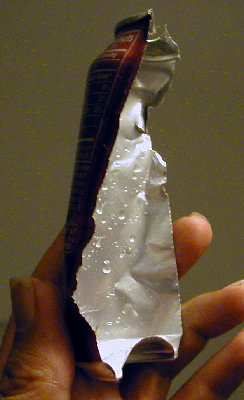

Yea right! minimal damage to the can.. As far as I can tell, it's pretty much wasted for being able to hold anything now.
Nice job on the cannon. It's larger than my current build.
As far as a guess as to the source of the damage, it looks like it hit a steel wire. Was this shot through a fence?
The torn edge wobble and the damage on the bottom of the can seen in your other photobucket photos indicate the can impacted on the bottom first. Since cans tend to quickly rotate and fly sideways, I'm assuming this impact was within a few feet of the muzzle, ie point blank range.
An ax head would have tried to separate the can violently. I don't think a wide object did this. The force would have distorted the can. It hit something narrow such as a wire. The wrinkle in the edge of the tear and the upward tear on the bottom of the can indicate this was not a hydrostatic blowout from an impact of a projectile from the other side. something sliced the can. See my updated theory below the photo.
If it was hydrostatic tear, the impact was on the bottom of the can with a small object. The tear at the top makes me think this is not the case. The top of the can separation is not uniform, so I think it was cut with a wire and not simply hit with water pressure.
It is still possible this damage was just hydrostatic from a projectile launched into the bottom of the can. The can split on both sides and opened like a clam and tore the top as seen. A high speed video of this would have been great to watch.
This is the photo I examined for the other view.
Update.. I think I may have the answer after thinking about it for the evening.
I think a can was loaded into the barrel empty with the top of the can going in first (top to the valve). On the shot, air blew into the can. The can pressurised in the barrel as it plowed air in the barrel along the way. Shortly upon exit (no chance for rotation) the can impacted something and split the bottom. Once the bottom split and tore to the sides, the internal pressure blew the can apart. This is my final theory and my final answer. The can on exit may have had as much as 30-50 PSI internal pressure.

very nice ideas! and mostly correct except the target, the target was a the edge of a piece of 1/16inch thick steel that was not sharpened in anyway. other than that it is all correct, the can was loaded open end to vavlve, and the target was only a foot from the muzzle.
and tech you definely need the larger cannon with higher pressure, this shot was done at 60psi and speeds slightly over 1000fps

well my 1000fps guess was bassed on the fact that i measured a can at 950fps at the same pressure and the 5ft barrel, and this shot was done with 10ft and i didnt want to be too optimistic.
did you get a clean split like i did or did it damge the can more? and was that a machete as your target?

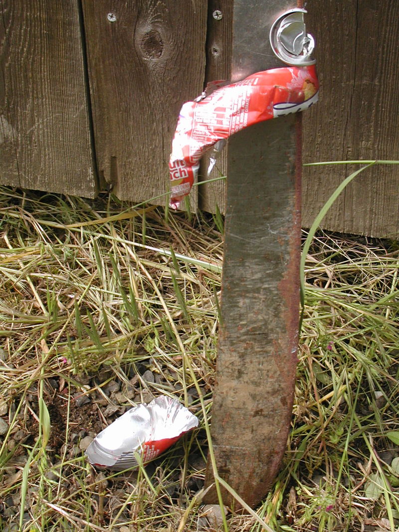

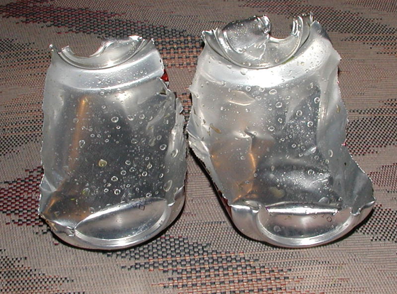

It's raining now. I grabbed the can and brought it in to grab a photo. Here is my can split with the 2 inch valve. My shot was at 65 PSI. It did hit the machete. The damage does look very much like your photo. The can was launched out of the 7 foot barrel. At higher pressure I might have gotten a cleaner edge. I posted the other picture as I liked the look of the can draped over the machete.

realy still that rough even with the sharpened target? i figure that you would be able to get a cleaner slice than me at lower speeds becuase of the non blunt target.
100psi and you should get a very nice slice
- Technician1002
- Posts: 5189
Due to the 2 inch valve and about the same pressure, my velocity was lower than yours. This damage is a cross between your shot and the marshmallow shot. Higher pressure would have made the clean slice. Due to noise I limited my pressure.
