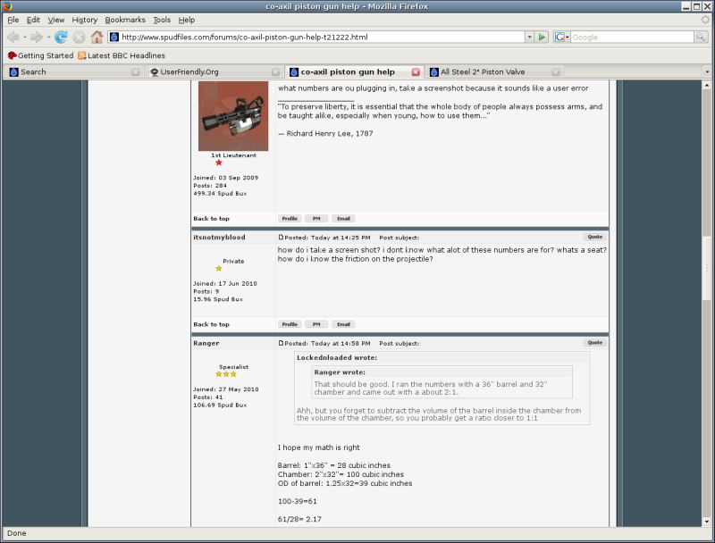

how do i take a screen shot? i dont know what alot of these numbers are for? whats a seat? how do i know the friction on the projectile?
I hope my math is rightLockednloaded wrote:Ahh, but you forget to subtract the volume of the barrel inside the chamber from the volume of the chamber, so you probably get a ratio closer to 1:1Ranger wrote:That should be good. I ran the numbers with a 36" barrel and 32" chamber and came out with a about 2:1.
Barrel: 1"x36" = 28 cubic inches
Chamber: 2"x32"= 100 cubic inches
OD of barrel: 1.25x32=39 cubic inches
100-39=61
61/28= 2.17
"About 2:1"

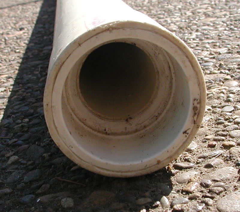

This barrel is most certainly shorter than the chamber. It is only longer when I screw on an extension.Ranger wrote: How can you make the barrel shorter than the chamber? They either have to be the same length or the barrel has to be longer. Think about it.

By definition, that is a coaxial as the chamber and barrel are on the same axis.Technician, we are talking about coaxial piston valve cannons not your awesome QDV design.
In my golf ball bazooka the barrel is shorter than the chamber. The breech of the barrel does not reach the breech of the chamber. The muzzle is recessed and ends very shortly past the end of the chamber. It isn't much shorter, but it is shorter.
