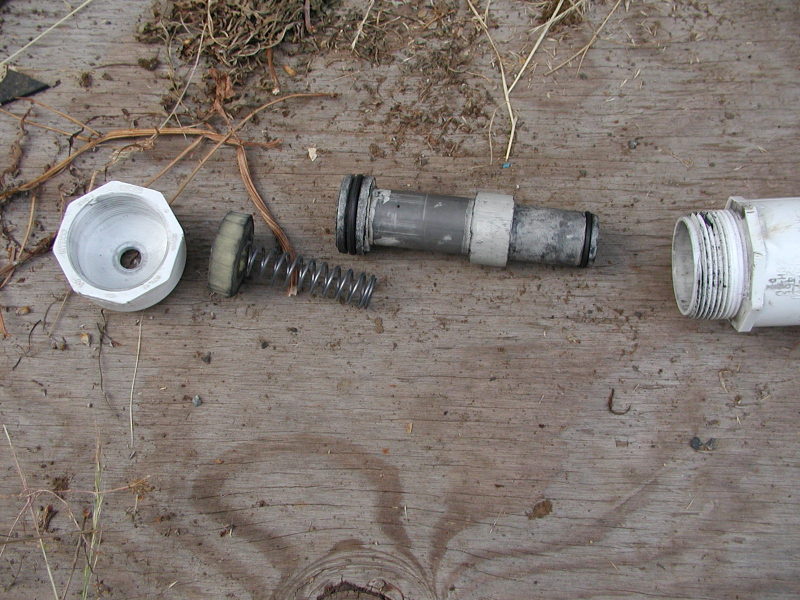

I tried that. In a nutshell, you will need a new o ring on the piston for each shot. Due to the way o rings seal, gas pushes the ring against one side of the groove and up against the wall of the cylinder it rides inside. As your cork comes out of the barrel, the ring in a vain attempt to keep a seal on the barrel will blow out of the groove and off the end of the piston. The ring joins the projectile downrange. Been there and done that with an early design.inonickname wrote:For the piston, I was thinking of something different. A stepped piston with two diameters. One fits inside the chamber, the other inside the barrel. The section in the chamber is standard for a co-ax piston. The section inside the barrel has an o-ring to act as a seal.
Thoughts? I was thinking of this to improve reliability, as my last co-ax suffered reliability issues with the piston.
Depending on the ring size, this can happen as low as 20 PSI. For a 1 inch barrel, it happened at about 50 PSI and above.
It took me a while of pumping to figure out that the piston would no longer seal for the second shot without the o ring. I launched a few rings before I figured out why they were lost.
I have a long list of failures before my successful builds. Don't be discouraged and learn from others mistakes so you don't have to repeat them.
The piston below does not come out of the barrel. It opens ports in the barrel. This was tried to keep the rings in place. The small ports I used were severely choking the flow. It was a ring of 1/8 inch holes.
