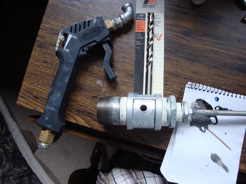

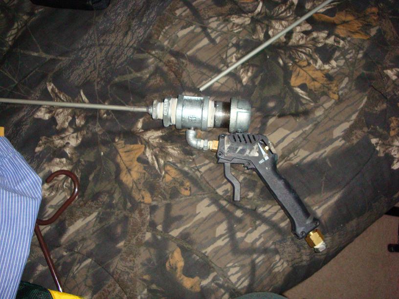

Hey all, after the dismal failure of this gun-- http://www.spudfiles.com/forums/unregge ... 19201.html
I've decided to give it another shot in a simpler design. It still uses a sawed down 90 degree tee, just inside 1 1/4" pipe. I'm waiting for the JB Weld on the barrel to dry, then I just have to attach the pressure washer handle and test it! Barrel is 12" brass tubing sleeved in brakeline

You know the internal pressure at max is only gonna be like 160 psi with unregged CO2 so you could have used like 1" pvc lol but still it's awsome and I want to see a video
No. When making a BBMG you want to prepare for a possible jam that could jack the pressure way up and PVC would instantly explode, especially with the cold CO2. Freezing CO2 is a terrible mix with PVC. I'm also planning on adding a ball detent for higher pressures and velocity.

Well i tested it.. and it did work! Firing was a little sporadic so I may add a plunger to help feed more reliably. Thing is a GAS HOG though. I emptied a 20 oz CO2 bottle in about a minute... so some sort of detent is definitely necessary, otherwise this thing will get expensive to shoot quick.
