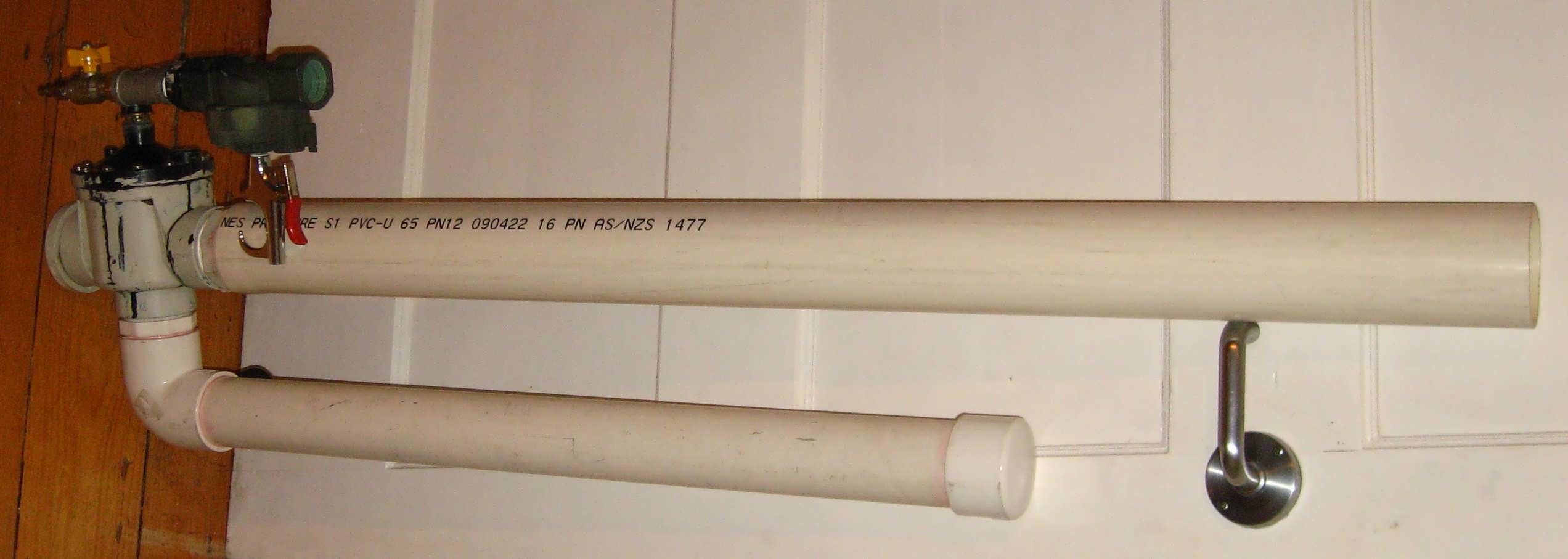

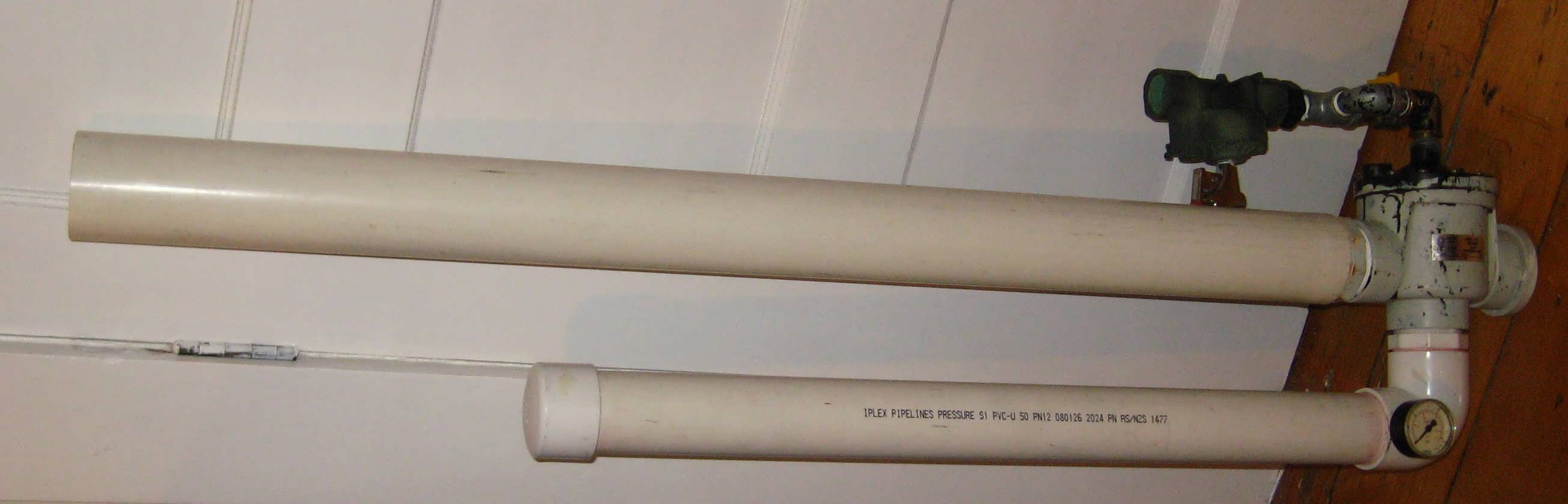

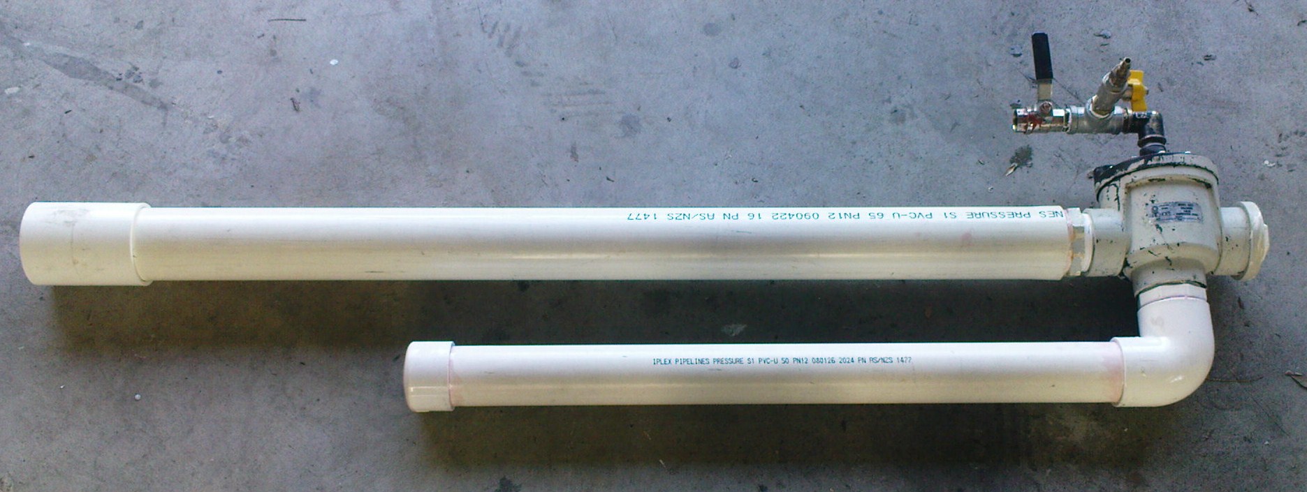

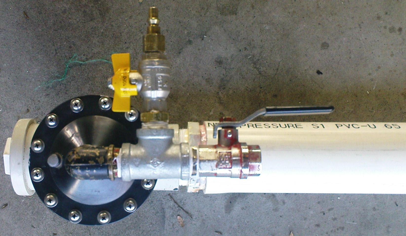

Just a little something I made with one of the 2" sprinkler valves I picked up. Even though the valves are 27 years old, they cleaned up really well and this one works fine. Not anything special really, just a 2" sprinkler valve (guide rod removed, piloted by 1/2" ball valve), a 3'x2" chamber and a 3.3' tennis ball cannon (65mm PN12 PVC). Also fits soda cans perfectly.
Can't be bothered painting it, this is just a fun cannon to use everynow and then. Pressure gauge has since been added. GGDT says 120m/s muzzle velocity with a tennis ball.

Hence the basic part haha. I probably could've saved quite a bit of money by just making a tennis ball barrel for my VAL cannon (1.5" porting piston valve) but I wanted something portable (can't get the piston to seal on the VAL using a track pump since I added the 1" sprinkler valve to pilot it) and I had four 2" sprinkler valves to useZeus wrote:Should use a piston valve.
Trivia: At my local plumbing store, they wanted $50NZD for a 65mmx50mm bushing (for the barrel), so instead I heated up the end of the barrel and a 50mm slip-socket male threaded adapter and managed to get it to fit inside the 65mm barrel and then once it cooled I removed it and glued it in.

Ahh I see. Yeah I probably could. Only reason I changed from ball valve to sprinkler was ease of trigger. GGDT says no noticable performance increase though.Zeus wrote:I meant as a pilot, because it's normally the other way around.
