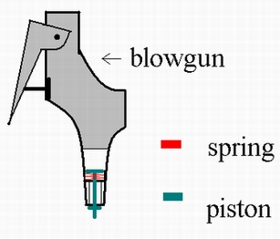

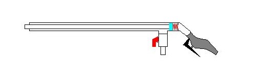

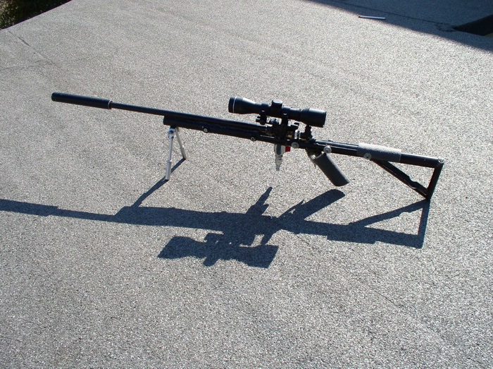

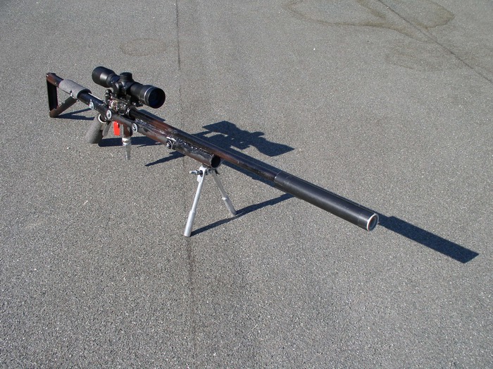

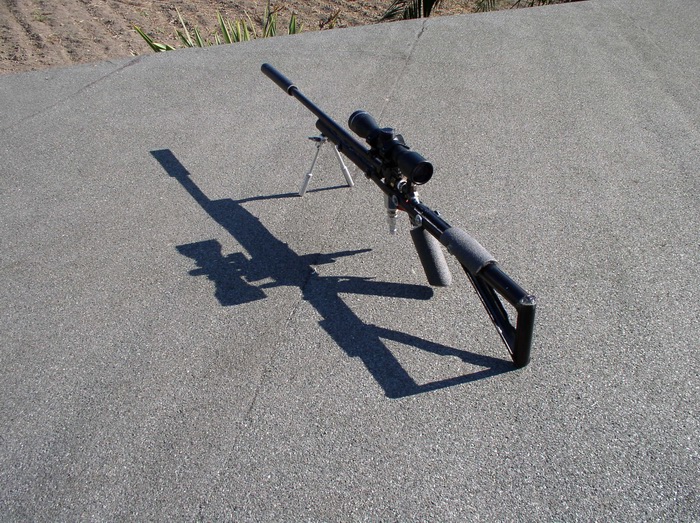

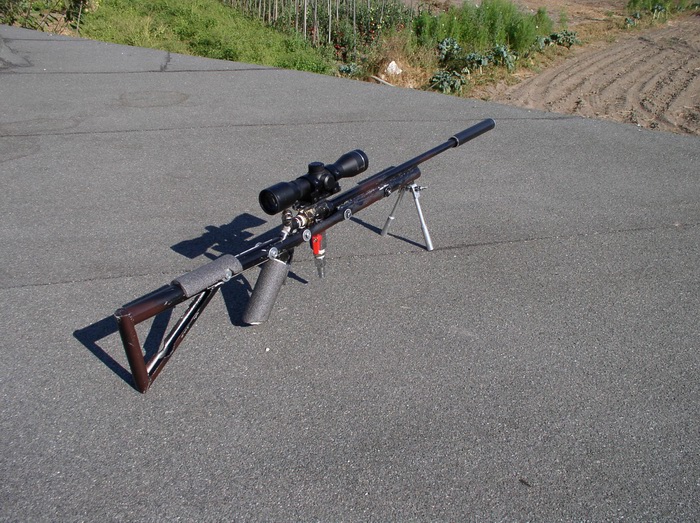

This is my latest pneumatic build.Before building it i made some objectives for this gun:
1.under 2kg
2.be accurant
3.be able to shot more than once with one charge
All come together and here is the final product.basiclly is a coax,when charged up to 100 psi,i can get +3 semi-auto shots :D .
ilovefire
Posts: 511
hey that looks really good man, would like to see some close ups and maybe a video, wouldn't mind making one myself :)
SpudFarm
Posts: 2571
Nice build! Can you tell more about the valve/operation details?
Some pictures of the valve internals would be good to :)
Good job!

all information is in my video :D [youtube] the pic may help too [/youtube]:)

That bb on your video is not .177, I think you have gotten your information mixed up. ,177 caliber pellets/bbs do not come in white, round or .25 grams. I believe that is a airsoft bb. The blowgun modification is great though, works like a check valve.

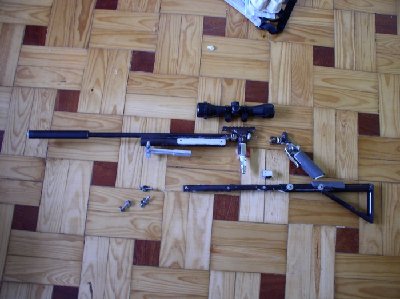

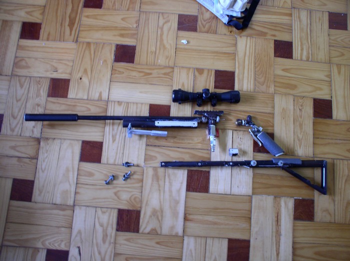

here is the gun separated, so it's easier for transporting

it looks really nice! and a very good idea for making it semi, never thought of something like that plug in the blowgun to stop the flow!
pretty cool sniper very authentic look
at what distance did you fire at these apples and what pressure did you use for that?

the distance is about 20m,with 60 psi
