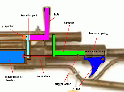

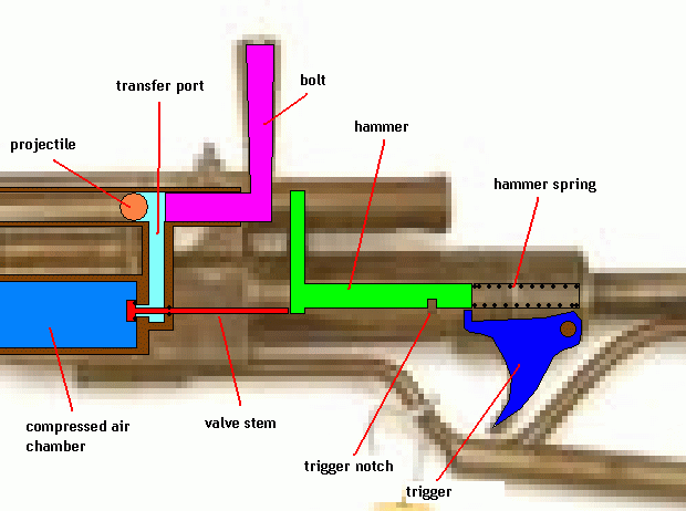

I'm in a spoonfeeding mood, this is most likely what the internal mechanism looks like based on what I can make out from the external parts.
The bolt is pulled back, exposing the magazine port and simultaneously cocking the hammer that is caught by the trigger. The pin on the magazine is pushed, intoducing a single projectile into the breech, then the bolt is pushed forward again and locked in place.
For firing, the trigger is pulled, releasing the hammer which strikes the valve stem, momentarily opening the valve which allows a burst of air to move through the transfer port and propell the projectile out of the barrel. The cycle can then be repeated.

Here's my two cents. I think there are several points that do not make sence in the graph"http://www.spudfiles.com/forums/files/p ... ls_906.gif"
First, the bolt doesn't have any practicle use except as a handle to cock the hammer. The designer could simply seal off the back end of the barrel and make a seprate handle for the hammer to achieve the same function.
Second, after the hammer strike, it will stay in the position that pushes open the gas valve causing the gase in the reservoir to empty, wasting most of the gas. this problem, however can be overcomed by using a spring that is slightly shorter than the length of the hammer housing, so the hammer strike the valve with its momentun, and is pushed back afterwards by the valve.
This is not true. The pressure in the tank will close the valve back even if the hammer is pushing it - how do i know - my homemade rifle works the same way, also some factory made rifles work the same way (like hatsan at44)

This is really a clever design, guys. Correct me if I'm mistaken, but this would be able to fire multiple shots on one charge, because the pressure in the air tank would re-close the valve, yes?

Mako...you are correct.
