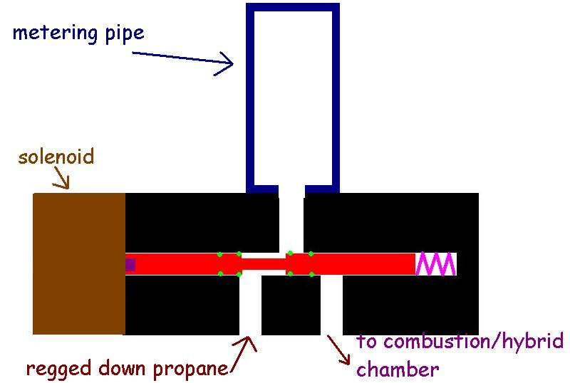

yeap, it has been suggested before
- the air pilot is just one of the possible actuators.... if you want to you can use solenoid, push button etc valves
- 3wayvalvescanbeusedformetering_duuh!;-).JPG (33.74 KiB) Viewed 4665 times
