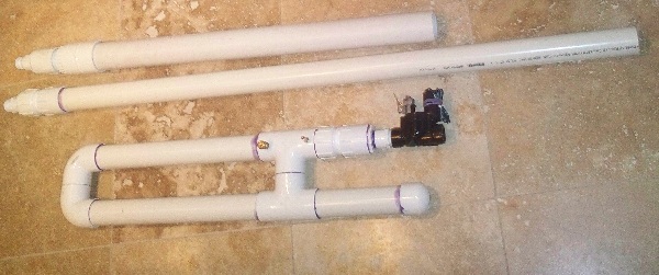

This is my second cannon - the CAKE II.
It is intended to function almost identically to the CAKE I
The valve is a 1" sprinkler valve modded with a blow gun.
I tapped in a shrader for filling with a bike pump, and a 125PSI pop off for safety.
The main changes are as follows:
-The chamber is now 2" x 48" of PVC, resulting in about the same chamber volume, but now in an over/under design.
-All of the fittings are now pressure rated
-The tapped in fittings now go through two layers of PVC.
-The chamber has a 2" threaded outlet which I have an attachment to reduce to 1" for the sprinkler valve. The reason for this is that I am currently working on a 2" piston valve.

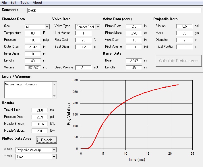

I have included the GGDT for launching a golf ball. Does it look like I entered everything correctly? The valve data comes from the GGDT website. The two things I wasn't sure about were the friction value, and whether or not I should change anything to account for the fact that I use wadding.
It still needs a paint job. I'm thinking black for the elbow and tee joints, and blue for the lengths of pipe.
EDIT: Changed the GGDT data to account for the wadding.

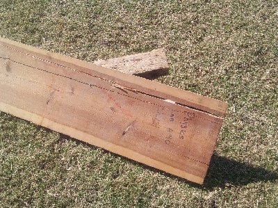

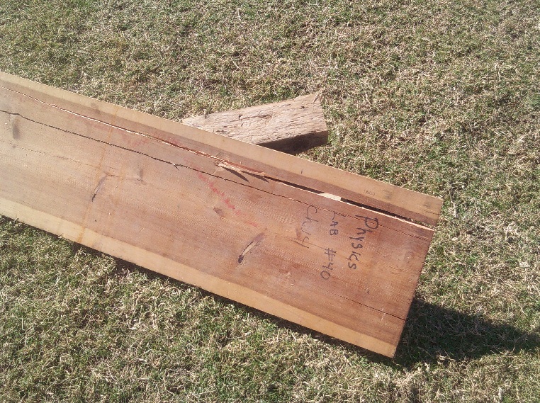

EDIT: Added damage pic

I think it looks nicer than the last one, and much safer too. I'm glad you took the general forum advice and rebuilt, you'd be amazed how stubborn people are even when their well-being is at risk

Friction is usually a fairly minor concern. A rough value will normally do.mlz3000 wrote:The two things I wasn't sure about were the friction value, and whether or not I should change anything to account for the fact that I use wadding.
As far as wadding... yes, definitely. You should increase projectile mass and diameter as appropriate. (If the wadding is good, near the full barrel diameter is a good bet for that value).
I don't know what your wadding is, but as a rough guess, I'd use 50-60 grams for the mass, and increase projectile diameter to 2".

Ah, yes, using 0.3-0.4 as the drag coefficient(that's the range of Cd's for a golf ball I got from a quick Google), I get a 544-654ft range. That sounds much more reasonable.
