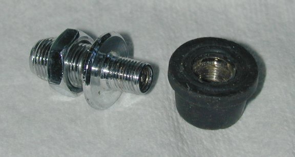

Or, you could go to your local tire store and ask for one of these.
- valve stem.jpg (27.3 KiB) Viewed 2055 times

Those are hard to install in a finished air chamber. This is for the fix, not a new one.
If it's possible to remove the schrader valve, you could cut through the chamber, then install the stem that Oxbreath posted, and then use a coupling to put the chamber back together.
Might not be the most elegant method (I would go with Tech's) but it might be easier.
