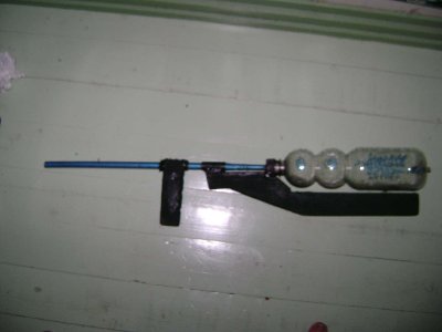

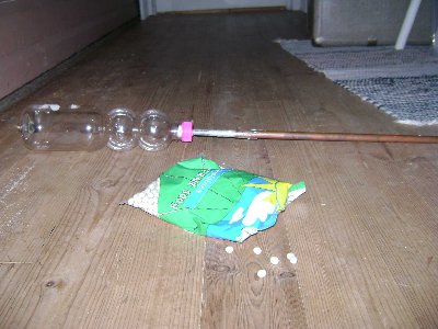

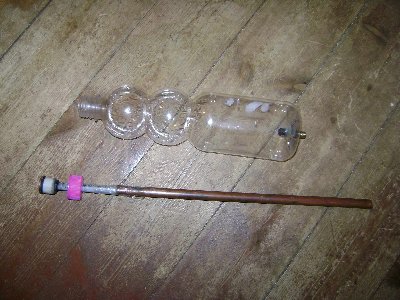

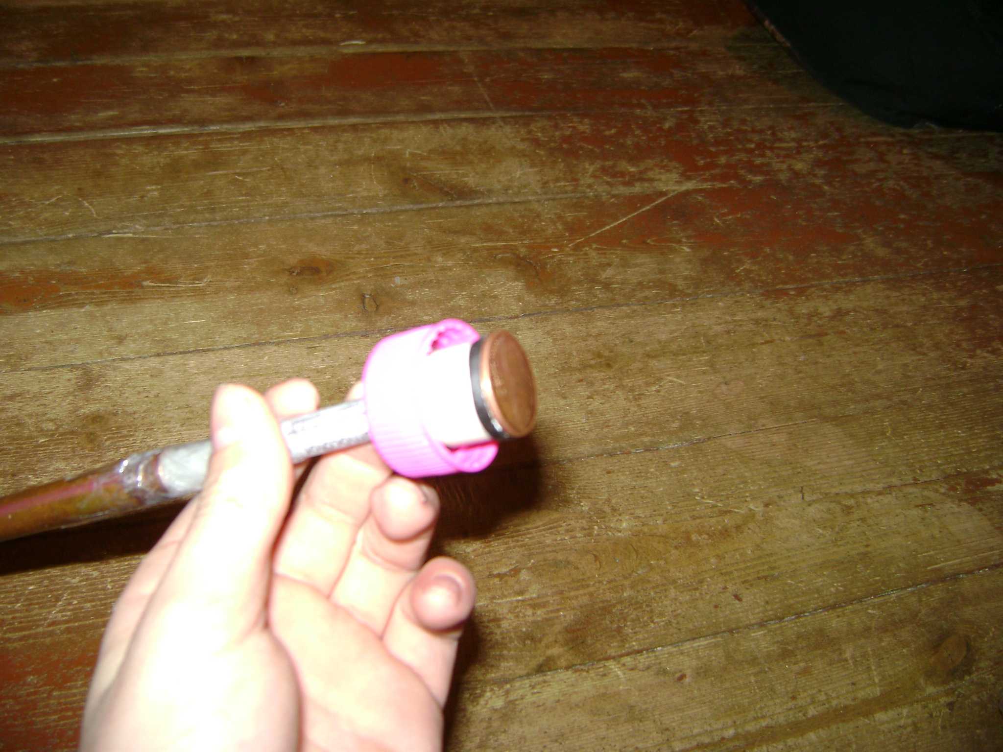

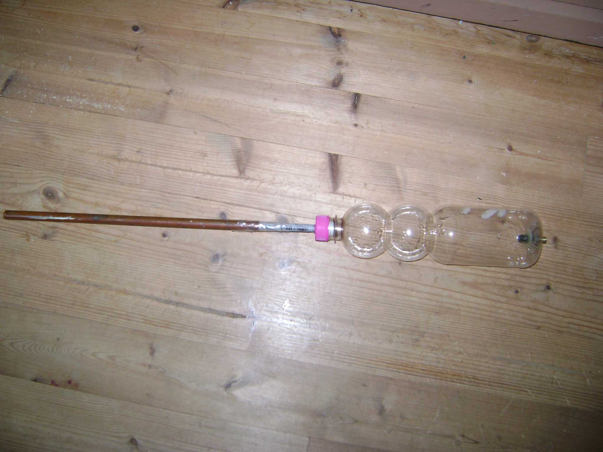

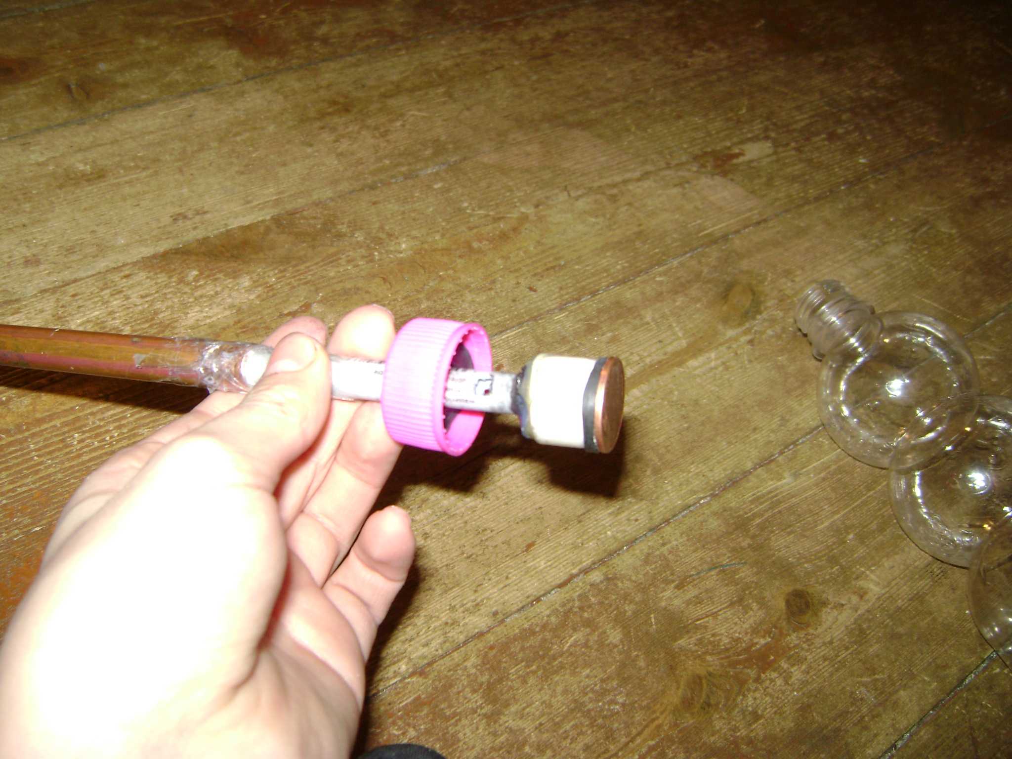

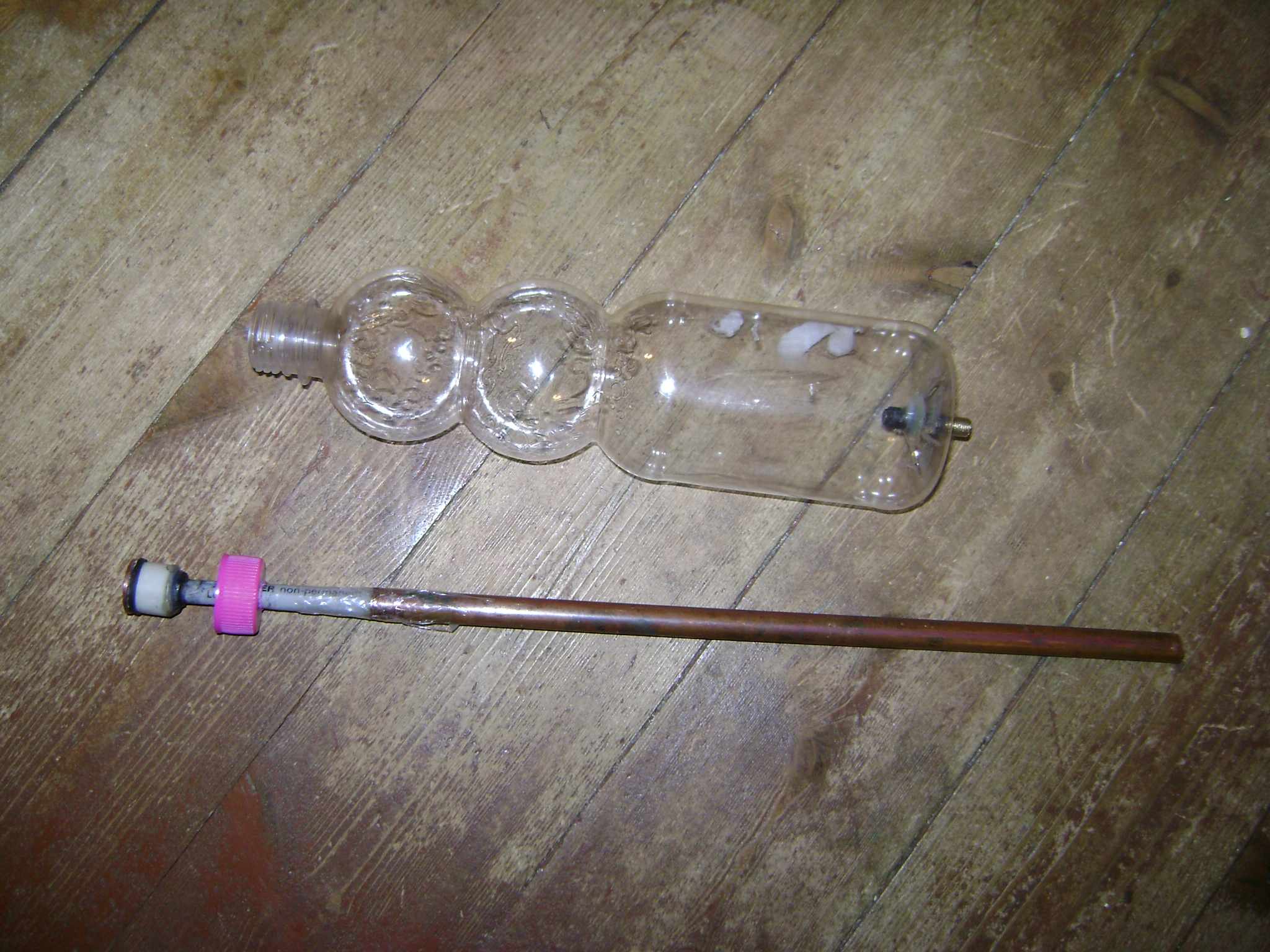

Hey i am new here and (sorry bad English) i am going to show you my lastest pneumatic gun that i have made. It uses valve that i havent seen here, there is a piston connected to the barrel and when you pull the barrel backwards, the air goes to the barrel from holes in that are in the barrel.

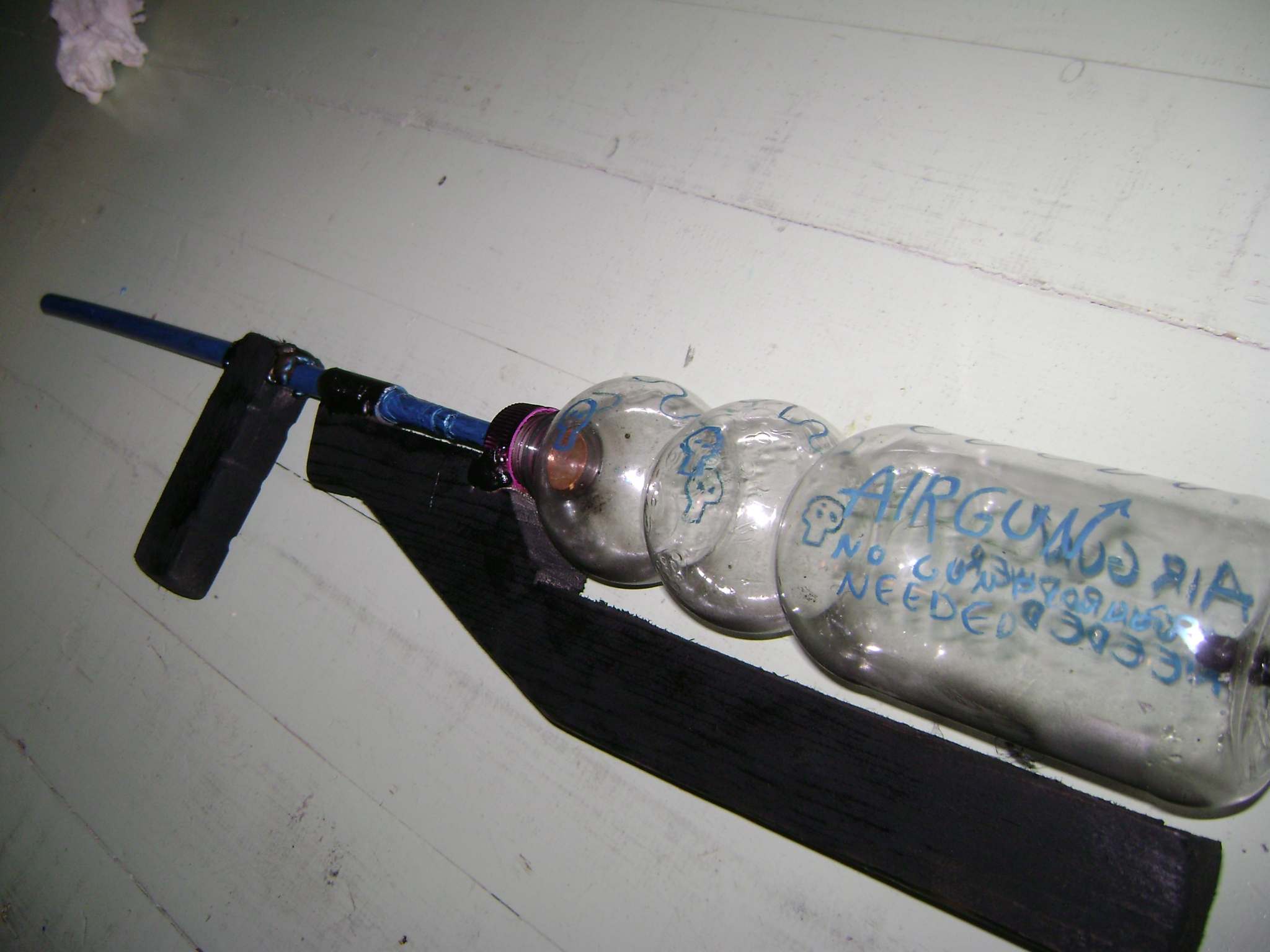

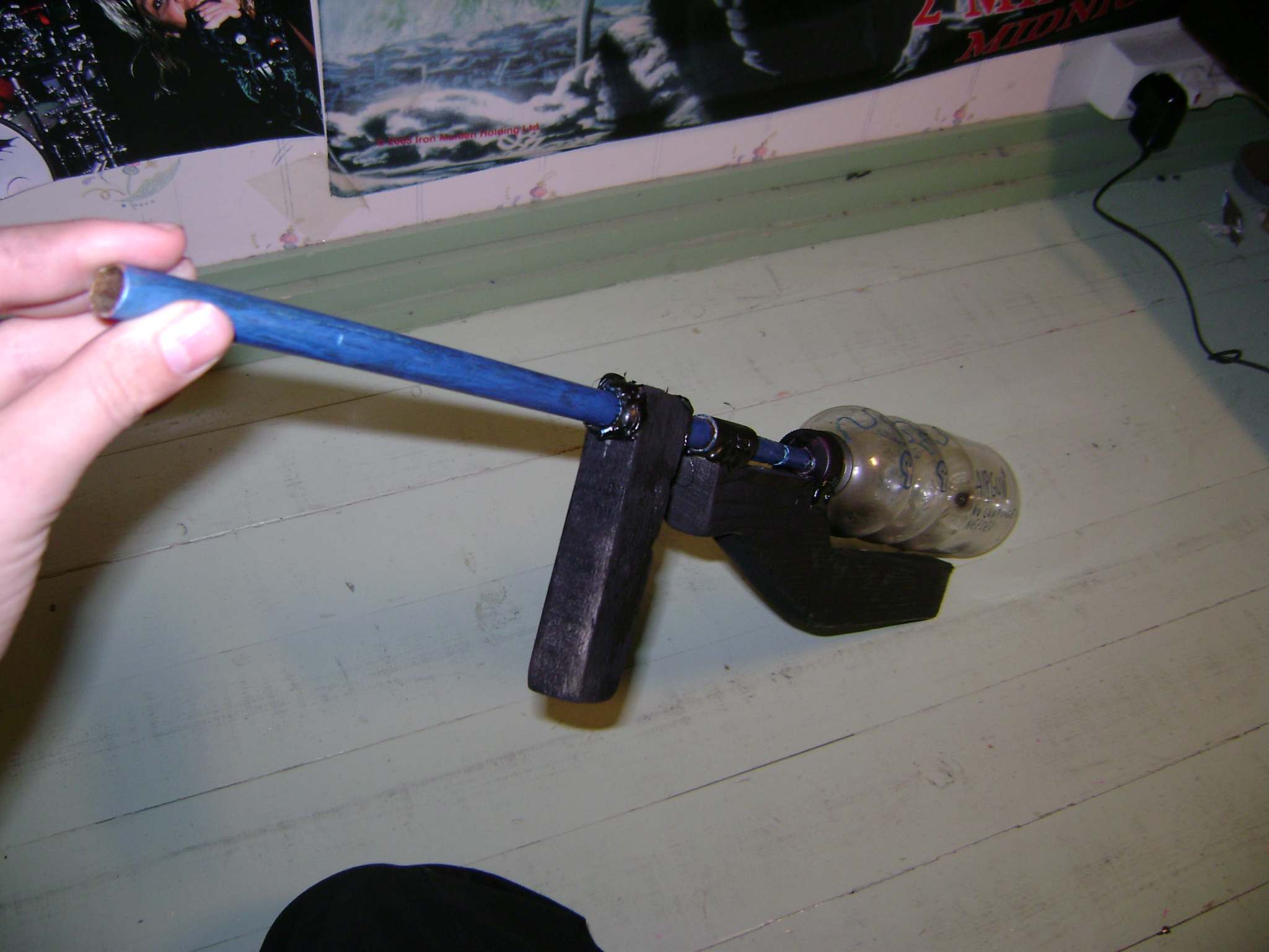

Now i added stock in the gun, painted the gun and did some more shooting. It can shoot a nail trough both sides of cardboard box.
The whole gun
The whole gun
Added stock and painted the gun.

This kind of reminds me of Tech's QDV..
The first thing that fell to my mind though is a external magazine for BBs that fall in when you push the barrel forward. Then they are fired when the barrel is pulled backwards, repeat and you have a rough semi..
Pretty clever IMO.
"Made in France"
- A spud gun insurance.
It looks like it has to push against the chamber pressure to open like a poppet valve. It would be impossible to use in larger sizes at high pressure.
I wonder if it blows off o rings at high pressure. Due to the chamber, I doubt it is used at very high pressure.
It does provide a large valve seat for a smaller barrel so it's rate of opening is very high and would open a gap with more area than the cross section of the barrel in very little time. It would be an extremely fast opening valve due to that.

Another vid here, very low psi in both videos because of my handpump... ... i guess under 25 psi because i could push the side of the bottle down with my finger.
Yes i am sure it would not work with high pressure, it pushes back even with as small pressure as that. Still good enough for me
