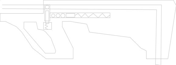

My idea is to have a horizontal spring load mag holding say 20 bb's. This has a push solenoid mounted below it that when triggered will push one round up into the breech block to be fired. The trigger is a simple DPST momentary contact switch that fires both the solenoid and the valve for the air flow. As long as you hold down the button the air flow will run but only a single round can fire as the plunger is blocking the BB feed.To fire again release and press the trigger. Power comes from a 12vdc SLA in the stock.
I have a picture to show this but am too thick to work out how to attach it to the post.
Any comments appreciated

Hopefully the JPG will explain it a bit more. Sorry for the rubbish image but my CAD program does a bad job of DXF to JPG

Ok, This is similar in concept to using an air ram semi setup, except that you're going electrical. By all accounts, it should work perfectly, provided the parts are machined well. It looks like you're planning on running it on a remote line to a firing chamber in the stock, with the valve being positioned directly after where the solenoid pops the round up.
I look forward to seeing your progress with this.

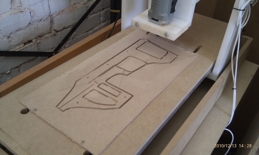

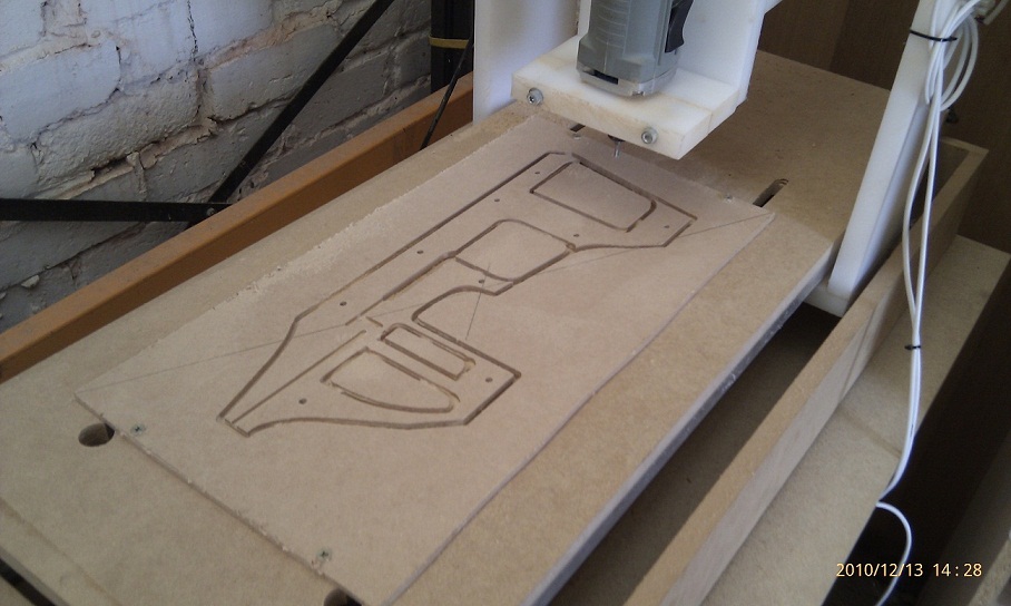

Making progress

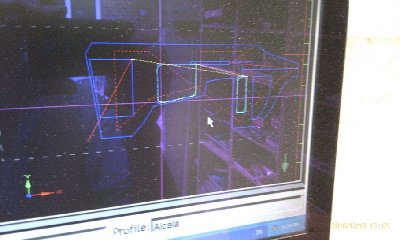

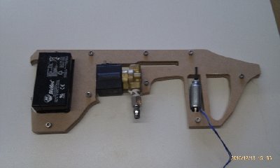

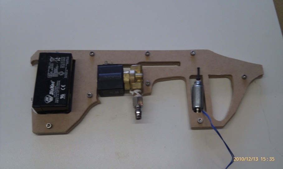

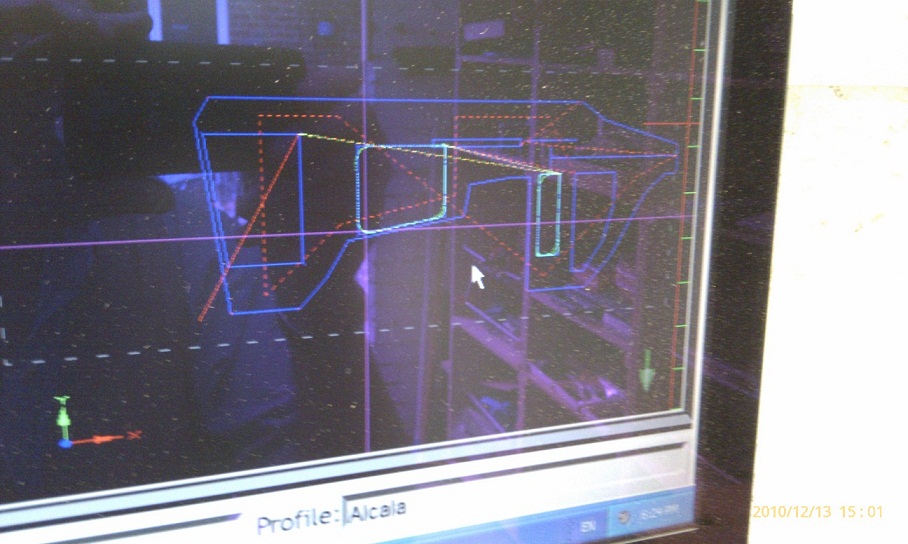

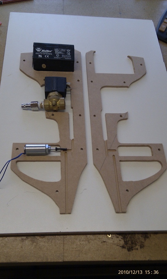

The prototype for the receiver is taking shape, just using MDF for now, the final job will be a series of mm plates of black HDPE. The laminated idea is simply so I dont have to bore and align magazine feeds and barrel housing for the upper receiver; I just make them in mirror halves then bolt it all together. Makes it easier for upgrades and maintenance as well.
The next step is to make two more half shells, this time only pocketed for the equipment rather than cut all the way through.
Cheers
Making progress
Cheers
