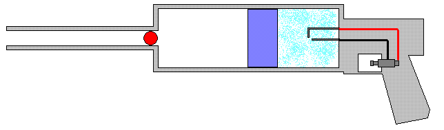

You could always use combustion to power the piston
- combustionpiston.GIF (4.8 KiB) Viewed 12048 times

So the second stage causes super heating and expansion? Couldn't you use a pneumatic piston to slam into the air cavity infront of it to cause superheated air expansion? It could be called the "Pneubustion cannon".
- Technician1002
- Posts: 5189
It is not in the immediate future. I have a 2 stage in the planning stage. Stage one will be the 8 gallon chamber with a 4 inch valve. The second stage would be a 4 inch piston compressing a volume for a golf ball barrel. I expect to exceed 1,000 PSI in the second stage with compression heating.D_Hall wrote:Which is how a 2-stage gas gun works.jackssmirkingrevenge wrote: You could always use combustion to power the piston
The second stage compression ratio should turn out to be about 20:1 to 30:1 or the compression in the Diesel engine.
