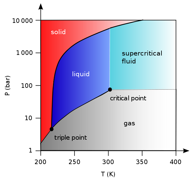

edit: gas phase diagram for carbon dioxide
room temp is roughly 300 K
- 630px-Carbon_dioxide_pressure-temperature_phase_diagram_svg.png (36.25 KiB) Viewed 4341 times

CO2 can be a liquid at room temperature, but only under high pressure. The critical point is a little above room temperature, but not much.
Simply compressing CO2 does not create a solid. It liquefies. When the liquid is then dropped in pressure, the phase change to a gas causes enough cooling to make solid form. Only under extreme pressure can you make a solid by compression, Study the phase diagram for room temperature. There is a lot of liquid before you reach solid.
Quote from http://www.science.uwaterloo.ca/~cchieh ... esdgm.html
At atmospheric pressure, it is either a solid at very cold temperature, or a gas at warmer temperatures. Dry ice sublimates directly into gas with no liquid phase at atmospheric pressure.The critical temperature for carbon dioxide is 31.1°C, and the critical pressure is 73 atm. Above the critical temperature, the fluid is called super-critical fluid.
