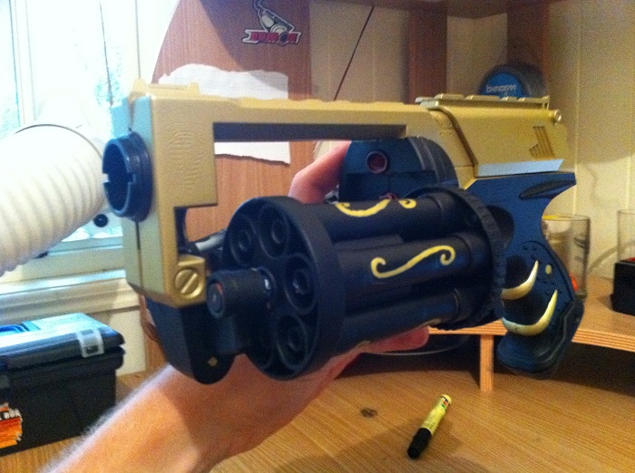

Ever since I was tiny I always wanted a BB handgun.. I got some short tastes of them on my trips to bali, but never had the balls to try and bring one back.

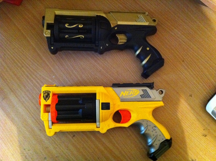

So I whipped this up yesterday... Its pretty much just a bb gun, not airsoft, but Id compare being shot by it like being shot by the handguns and shotguns I had in bali.. So its fun for around the house.

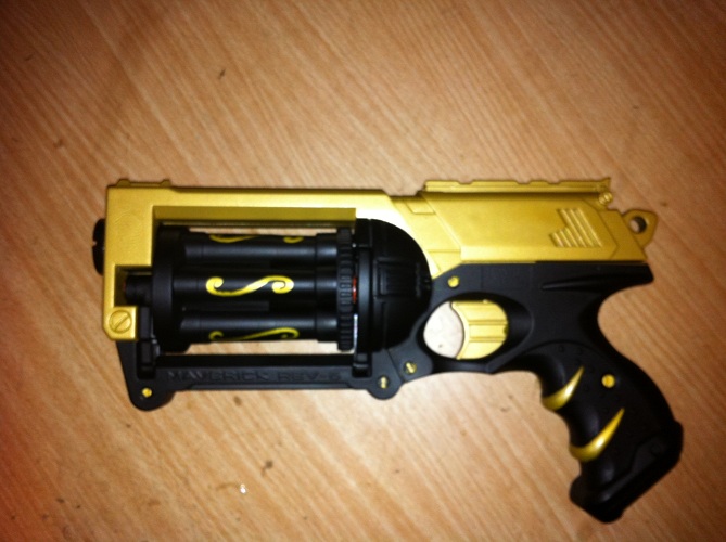

Its a modded Nerf gun.. I changed the barrels etc, took out the restrictors, improved the seals, and increased the strength of the spring.. Oh and gave it a little paint job :D
It hurts, and will leave a little welt depending on the distance you get shot from..
Total cost was $22... And Iv been using 6mm beads as ammo..
So there you have it, for all those kids in aus who have always wanted a low strength(ish) BB handgun.. Here it is :D
Im about to make a second as a christmas gift for my girlfriends brother... House wars time :twisted:

Interesting, one thing that is desirable in springers is to have the pellet restricted at the breech in order to allow pressure buildup but in this case due to poor drum/breech interface it wouldn't really work out.
If you want to make a better mod, ditch the revolver magazine completely, fit a fixed barrel and inline magazine.
Believe it or not, it actually does have a setup slightly like that... inside the barrel there is shrink tube at the back end.. when you load and put the bb it the barrel it gets stuck in there, sort of creating a seal..
I considered going with a fixed barrel setup, with a sliding tube over the barrel which slides back as you cock it and lets in a bb.. but then its just getting complicated and I wanted something I could eaassiilly make 5 of..
Though it may be on the cards in the next month or so.. What were you thinking design wise JSR?
