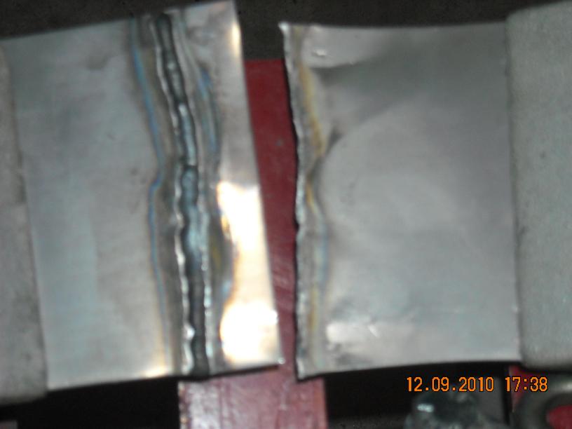

TIG weld will hold no problem
any good weld should be stronger than the substrate
in addition he is working with much lower pressures if your talking about your hybrid.

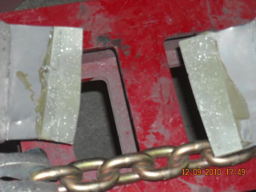

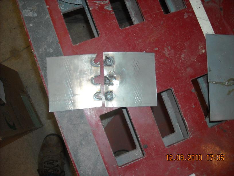

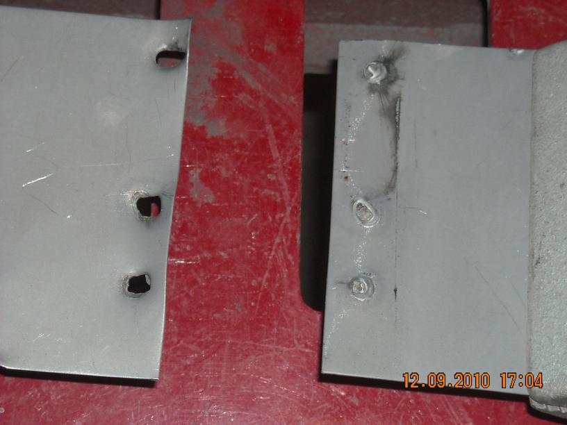

I have added some pictures of weld failure and a glue used in automotive assembly that was part of my recent school science project.

The issue as shown above in the photos is either the weld is weakened or the metal adjacent to the weld is weakened. Note the bead weld broke at the weld, not somewhere else. The failure at the welds is common. This is why high pressure tanks are never welded. Only low pressure tanks such as Propane tanks are welded.
Oxygen, Argon, and CO2 and SCUBA tanks are one piece construction. They do not have welded fittings.

The bead weld failed in the HAZ of the weld, the weld itself did not fail, there is a small amount of the base material from the failed piece still in the right side of the weld bead.
