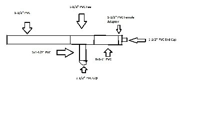

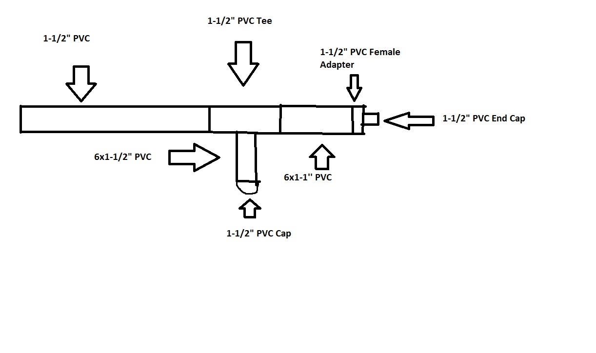

Hello. I've recently built myself a new cannon. This cannon has a smaller chamber and is more compact. I'm going with the syringe method of fueling the chamber. I know how the method works, however I don't know how to calculate the chamber volume in ML. My chamber splits from a Tee in the middle. Look in the attached image to see what I mean. Is there some kind of calculator or formula I can use to figure this out? And yes I have looked on the Wiki.

fill it with water?

Any easier method? The barrel is already glued together and so is the chamber, and is dry. If there is no other method how would I go about this?
Every inch of 1" pipe is 13mL, every inch of 1.5" pipe is 29mL

Aaaa. I see thank you. So sense the chamber splits into the handle would I just add up those inches from where it splits?jackssmirkingrevenge wrote:Every inch of 1" pipe is 13mL, every inch of 1.5" pipe is 29mL
Yes, the result will be an approximation but in practice it won't affect your performance.
