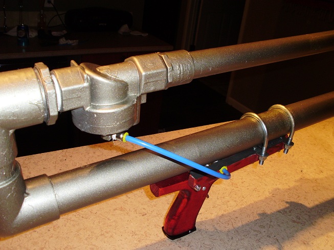

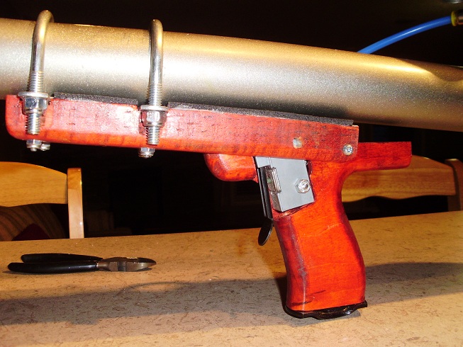

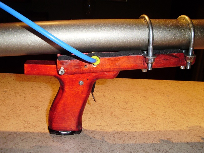

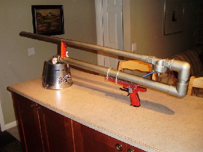

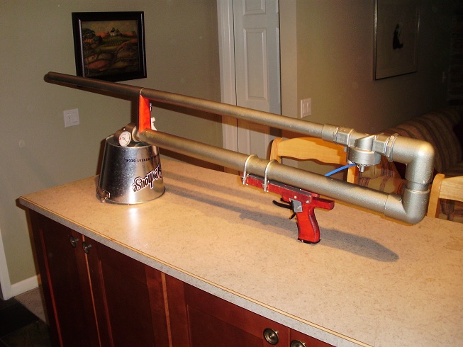

So, this is my first spud gun. Mentioned it briefly in the pneumatic discussion forum, the paint is more or less done though, so, here it is.
Still needs some tweaking with the looks, but, functions great.
Also, the name, I just came up with that on the fly. Pay no mind. :?
Pretty standard sprinkler valve pneumatic. 36" x 1.5" tank, 48" x 1" barrel. Actuated by a toggle valve.
All xirtec140 sch 40 PVC.
Wood parts are rock maple with a bit of stain and lacquer.
Posts: 3643
Been thanked: 62 times
Holy- :)
Nice! That paint looks good and blends well with the steel hardware used for the barrel brace (hose clamp) and attaching the pistol grip.
Nice pilot valve, too. Is that a three-way DCV?
Only thing I can possibly think of as far as suggestions is that you probably should have cut the connecting piece of pipe between those elbows shorter so that they butted up together flush. Not a major concern, though.
Nice job again, hope to see more down the road.

I really like it!! the paint and the pistol grip complement each other in contrast. The trigger is nice too, good job.
This is being petty, but what if you added a foregrip out of the same wood as the pistol grip?

I feel the same way about the piece between the elbows, but... c'est la vie.
The 3 way valve has the sprinkler honking a little, now that I mounted it in the handle. It wasn't before I assembled it all.
The out port on it flows down through the bottom of the handle, I think I may need to split the flow into channels, not just the one.

Nothing beats a good old fashioned wooden grip. And a uniform routed round-over to boot! I'm pleased.
As mark said, you probably could have built more for compactness by shortening that joining pipe, but it's not a big deal considering this is your first build.
The paint does look good, and I trust that it is intended for use on plastics. I'm more a fan of flat black next to wood grain.
