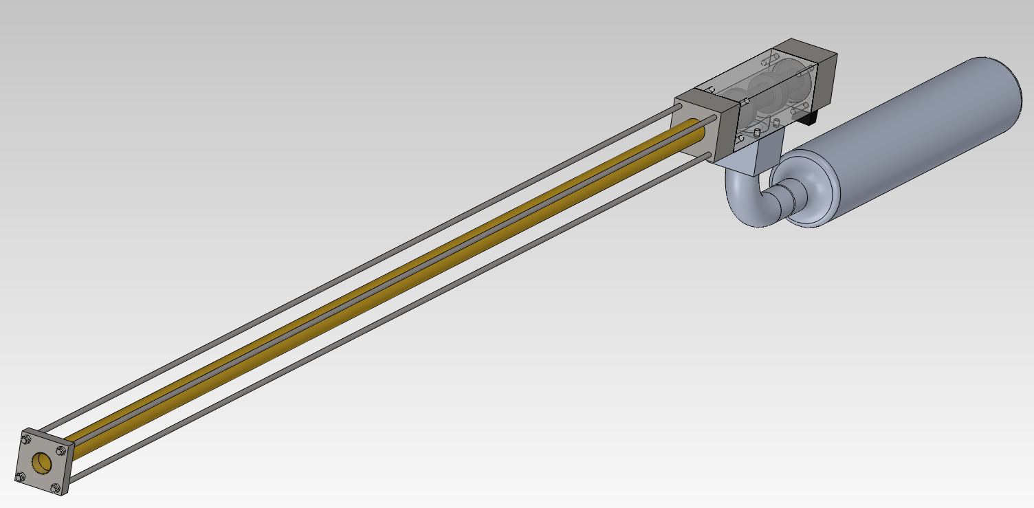

Hi
after 2 days of sitting in front of "Solid Works" our new projekt is designed and without any more words i post it now:
Looks like Hell ;-)
Looks like Hell ;-)

Why not bullpup ?
I'd rotate the chamber 180 so the recoil force is not on the valve and place a stock on the breech. Looks great.

don't know what size this thing is but i doubt you need to barrel supporting all-thread thing just thread the od of barrel and id of the valve, if you can.
but the all-threads do give it the don't mess with this look :lol:

Hi
i think we can build a breach loader for this but it will be verry hard cause the pipes are "emidiopipes"
