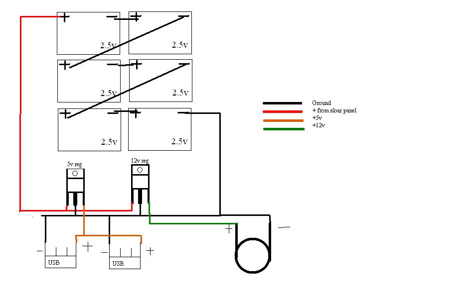

I recently had an idea to build a solar charger for USB and car charged devices for use when camping. I am a Boy Scout and on one of our recent trips had some dead cell phones and no way to charge them.
The solar panel would be made up of cells from outdoor solar lights.
The voltage from the panels would be regulated by 7805 and 7812 voltage regulators for USB and Car outlets respectively. I am thinking about putting some sort of quick connect in between the circuit and the solar panel so that power can also be supplied though batteries, maybe a wind turbine, or a wall transformer.
Solar charger idea

Those solar panels give very little current, the design is fine, but unless it's only one phone a day, it won't do a lot.
Now if you left the charging circuit and batteries from the solar lights, and connect the batteries as per the schematic, you'll be on to something good.

I knew that the panel can't provide much current. Are you sugesting that the panels charge the batteries and then the batteries charge devices?

At 15 my electronics experience is limited to the electronics merit badge, tearing things apart and internet research so any guidance on the charging circuitry would be greatly appreciated.

This year at summer camp the Ipad was the "cool new toy". It has yet to be diminished of this status. We have plenty of outdoor activities within the troop. One of the main attractions being my advanced combustion cannon. This is just meant to maintain batteries for emergencies and to power devices in case of emergency.
- Technician1002
- Posts: 5189
Before you build it, serious consideration must be given to the power requirements. Many cell phones will draw a fixed charging current for the high rate charge, then when the battery is up, shuts off and announces the battery is charged. This current can exceed 500 ma on some phones.
The soler chargers on the other hand don't put out nearly that much current, so the phone would attempt to charge, then the overloaded solar source would be a voltage crash and the charging circuit would detect that as a power failure and shut down. In short, it won't charge.
If you keep the solar cells and the light batteries together, then the lights can charge their batteries and then you can provide a short term high current load such as charging a phone.
In a situation where power is scarce, it makes little sense to throw over half of the power away as heat. The regulator you have chosen is an Analog regulator. It would take the ~15 volts in the charged solar lights batteries and turn 2/3 of that into heat as it drops 10 volts on the regulator and 5 volts on the charging phone.
Find a high efficiency switch mode power adapter instead. They work by dropping the voltage but generating very little heat. Instead of taking in 15 volts at 1/2 amp (7 watts) and putting out 5 volts at 1/2 amp (2.5 watts) with 5 watts used to heat the regulator IC, the switching regulator takes in about 2.7 watts and puts out 2.5 watts at 5 volts and generating 0.2 watts of heat in the regulator (none are 100% efficient 80-90% is typical). This gives over twice the charge into the phone for the same amount of solar power.
For 12 volts I would toss the 12 volt regulator. A car charging system when running is about 14 volts. The ~15 volts on the solar battery pack will not cause any problems with most electronics designed to run off a car lighter socket.
More info on the charging requirements for an iPad is on this page;
http://www.neowin.net/news/the-ipad039s ... ing-caveat
There are a couple of things to note, the fast charge takes 10 Watts or 2 Amps of power for the fast charge. To get the iPad to take a fast charge the USB port must communicate with the iPad that it can provide high power. Same for the other two power levels. Normal high power at 500mA (2.5 watts) or 100 mA for low power. Just jacking into a powered USB jack with 5 volts and no communication will probably place it in the slow charge mode.
Many of the solar lights charge their internal batteries at under 20 mA. (0.02 Amps) Feeding an iPad looking for 2, 0.5, or 0.1 Amps will show the difficulty of using the solar lights directly without stored energy.
In a nutshell you will need to collect 50 hours of direct sunlight charge in batteries to provide 1/2 hour of 2 Amp current to the iPad.
Saved and used power is measured in Amp Hours for charging batteries and Watt Hours for measuring power use. Two hours of high current iPad charging (10 Watt rate) is 20 Watt Hours.
A solar light that charges a 300 mAH battery at 3.6 volts has saved a total of 1.08 Watt Hours during the entire day. A bank of 20 of the solar lights would be the bare minimum to give the I pad a 2 hour quick charge not counting loss in the regulator.
Check your solar lights to find the battery capacity. That will give you an idea of the total maximum amount of power they could possibly collect in a day. They of course run down completely at night.
For charging phones (not an iPad) a 3 watt 5 volt panel is recommended as it will provide the required 2.5 watts many phones require. This is a typical panel made for this application;
http://www.google.com/products/catalog? ... CF8Q8wIwAQ
