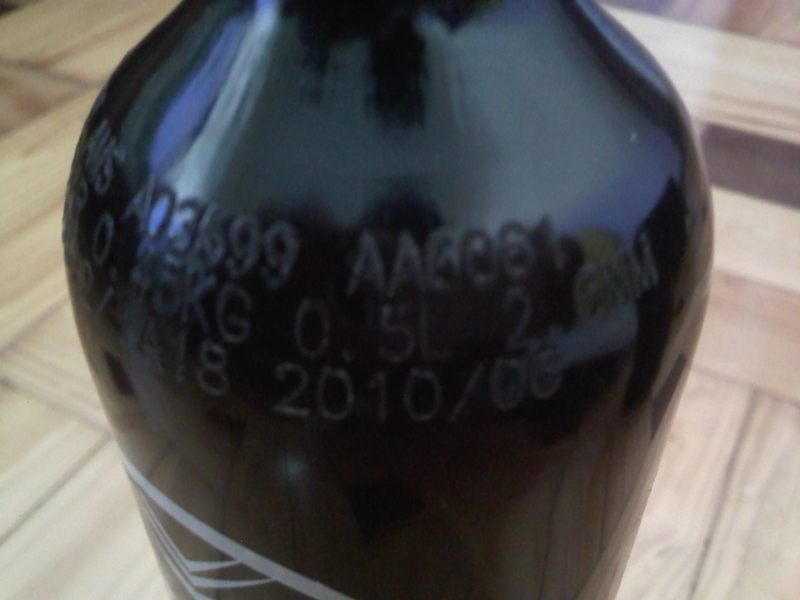

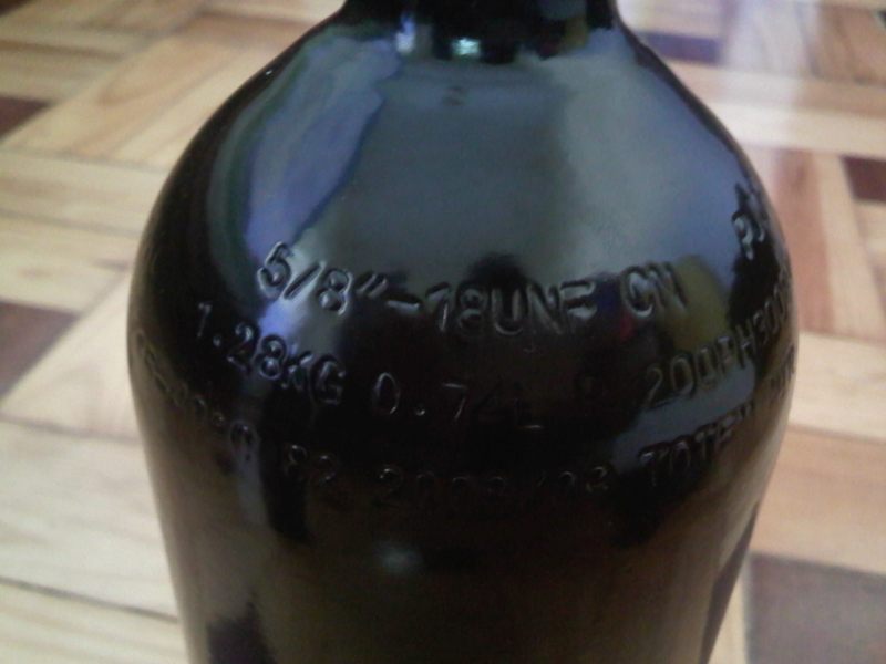

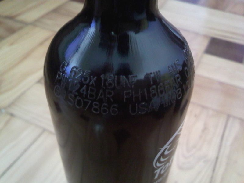

I´m sure, it´s written on the bottle :roll:
co2 bottle
co2 bottle
co2 bottle, it doesn´t say the dimension
compressed ar bottle
So you just bought the bottle without any valve whatsoever?
