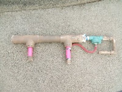

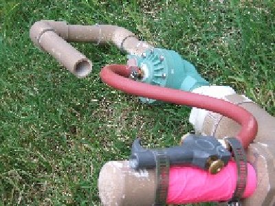

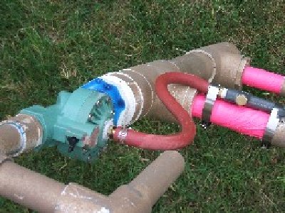

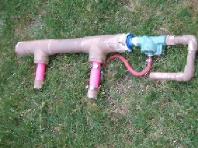

I finally added a stock to the coax. Whenever someone shot it, the valve vented right on your ear, so I measured and added so now when I put the stock against my shoulder, my hand comes out right on the blowgun. It is now much quieter and easier to use.

There is a schrader tapped into the plug. I love my bike pump. :D

The paint job is not very nice ... and the pink grip dont match with your gun ...
but the cannon must be powerful !

Exactly. Why would I want to have the colors match? That takes all the fun out of it. And the paintjob is good, it's just an ugly color. :D
The C:B ratio is 9.5:1, yes, it's strong. I can shoot a paintball 820 fps.

I started making one of these the other day and I must say, it was real bitch trying to allign the two tees. They came out a smidgen crooked but oh well, it'll still shoot.
noname
Posts: 2698
Location: Bay Area, CA
I don't even use the front T anymore because of the stock. I couln't find any Ys so I just used Ts. Try gluing on a flat surface.

what is your diaphragm made of. Mine is most likely going to be fixed.
noname
Posts: 2698
Mine is just some 1/8" thick neoprene rubber.
